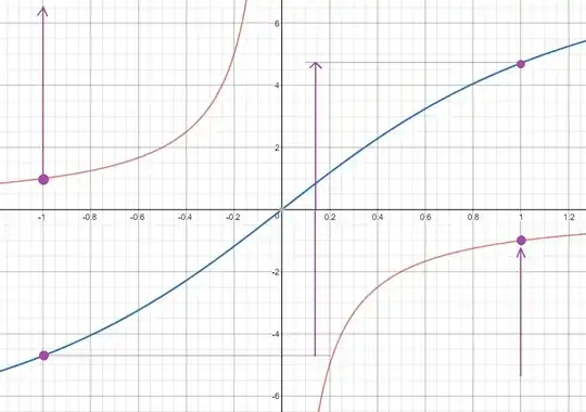

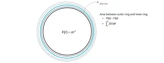

When you first looked at an integral like $\int_{-1}^{1}dx/x^2$, your instinct was to apply the fundamental theorem of calculus, and evaluate $[-1/x]|_{-1}^1$. This answer was clearly wrong, but why? Why does having a singularity in between screw up the fundamental theorem of calculus?
Well, you might have the intuition for the fundamental theorem of calculus as having to do with, e.g. a disk expanding outwards, and the derivative of the area being the circumference -- so with some $dr$ added to the radius, $2\pi r\cdot dr$ is added to the area. And with a lot of $dr$'s getting added, the total addition to the circumference -- the integral of $2\pi r$ across the total length of $dr$'s that got added -- is the difference in area over the expansion.
But you might imagine a set-up where there's a singularity somewhere in the expansion, so the area suddenly blows up to infinity somewhere in between the expansion, then starts back from 0 1. Something's not quite wrong here. Our intuition just broke -- the actual amount of area that got added isn't the same as the total area change here.
Like in our exercise above, let's look at the antiderivative of $1/x^2$ between -1 and 1. And for comparison, we'll keep another function -- a normal, continuous function -- and its antiderivative.
And that's the fundamental problem here -- the integral is taking a different path (and if you wrapped the xy-plane around a sphere, you'd actually be able to visualise this path as going all the way to infinity then coming back from behind) from the $F(b)-F(a)$ calculation. $F(b)-F(a)$ is -2, but the path taken by the integral is in fact, $\infty-2$.
On the real line, there's no other path you can take (besides going to infinity and coming back) on which the integral is valid. But if you could just budge the path a bit "out" of the xy-plane, it would be valid, because you wouldn't be going to infinity -- just a really high number. An example way of doing this is to use complex numbers, since the added dimension allows you to draw the path between -1 and 1 a little out of the plane, and take the limit as this "little out" approaches 0. As an example, you can look at the integral:
