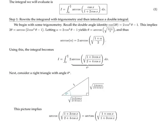

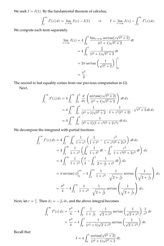

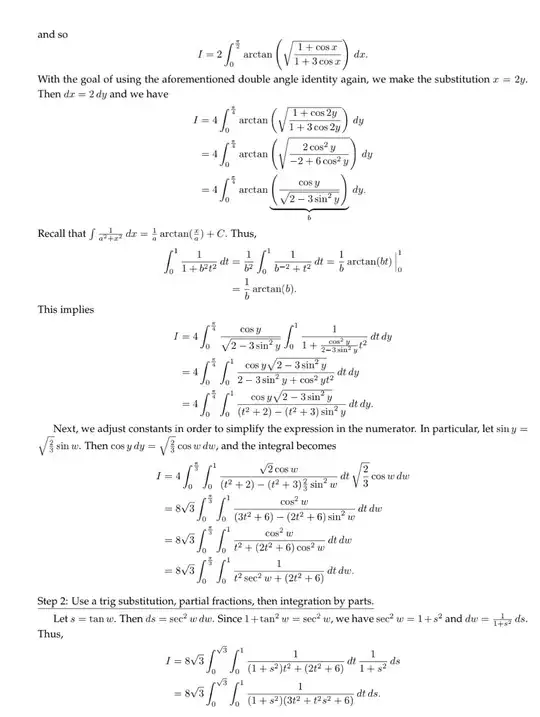

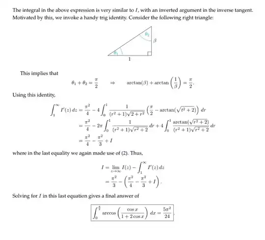

Here is the method to evaluate this integral. enter image description here
Source:- Some very challenging calculus problems by Joseph Breen
