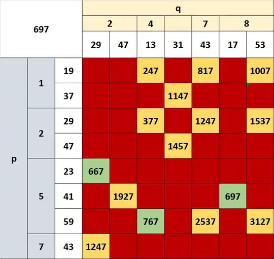

Further steps for 697:
The digital root of 697 is $dr(697) = 4$.
Using this the Vedic square again, we see that:
$$\{(dr(p),dr(q))\} \equiv \{(1,4), (2,2), (4,1), (5,8), (7,7), (8,5)\}$$
are the possibilities. Due to commutativity of multiplication, we can consider the reduced set:
$$\{(dr(p),dr(q))\} \equiv \{(1,4), (2,2), (5,8), (7,7)\}$$
Check the primes $11 < p,q \lt 60$ i.e., $13, 17, 19, 23, 29, 31, 37, 41, 43, 47, 53, 59$ Their respective digital roots are: $4, 8, 1, 5, 2, 4, 1, 5, 7, 2, 8, 5$
So, $\{(p,q)\} \in \{(19,13), (37,13), (19,31), (37,31), (29,29), (29,47), (41,17), (47,29), (47,47), (23,17), (23,53), (43,17), (43,53), (59,17), (59,53)\}$
We can eliminate redundant pairs using commutativity:
So, $\{(p,q)\} \in \{(19,13), (37,13), (19,31), (37,31), (29,29), (29,47), (41,17), (47,47), (23,17), (23,53), (43,17), (43,53), (59,17), (59,53)\}$
Using $697 \mod 10 = 7$, we can eliminate pairs leaving only those marked by the green cells in the figure below:
Figure
Of these 15, we can eliminate all whose products are lesser than 697 or greater than 697 by using the product of numbers rounded to nearest 10. For eg: $19 \times 13 < 300$, $29 \times 43 > 800$ and so on. You need to check only 3 products $(667, 697 and 767)$ by hand to find out that $697 = 17 \times 41$
Final elimination matrix
