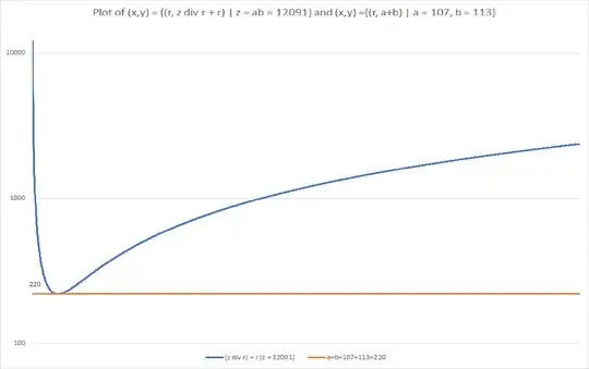

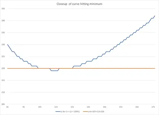

There is an interesting empirical observation from the plot of $\lfloor {z \over r} \rfloor + r$ and its relationship to the sum $a+b, z = ab$ with $a,b$ positive. Plot shown below for $z=12091, a+b=220$.
Plot of z div r + r and its relationship to the sum a+b, z = ab
Here is a closeup of the range where the curve hits minimum.
Closeup of range where curve hits minimum
This means, if we pick a reasonably good estimate for $\lfloor {z \over r} \rfloor + r$ with $r = r_e$ being the corresponding value of $r$ and also pick random $r_0$ and $r_1$ such that $r_0 < r_e < r_1$, we can then determine the minimum $\lfloor {z \over r} \rfloor + r$ using successive bisection of the range $[r_0, r_1]$ since the minimum value of $\lfloor {z \over r} \rfloor + r$ must lie in either $r \in [r_0, r_{mid}]$ or $r \in [r_{mid}, r_1]$ where $r_{mid} = {r_0 + r_1 \over 2}$.
The initial estimate for $r_e$ could be:
$$r_e = {{2 + \lfloor {z \over 2} \rfloor} \over 2}$$
With successive iterations, we narrow the range until we are left with a range of width 1 $(r_1 - r_0 = 1)$ and one of the range bounds must result in the minimum for $\lfloor {z \over r} \rfloor + r$. This would require $O(\log(z))$ steps.
Conjecture C1: The conjecture is that the actual value of $a+b$ lies within a bounded distance from the minimum of $\lfloor {z \over r} \rfloor + r$ for composite $z$.
I am not sure if this conjecture is true. It would be very interesting if this conjecture is indeed true and the bounded distance is small relative to complexity of other factoring algorithms.

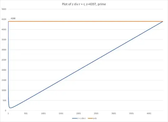

For $z$ prime, we get a plot as given below (example for $z = 4397$, prime):
Plot for prime
As we can observe, for prime $z$, the distance between the sum of divisors (i.e, $a+b = 1+z$ is maximal from the minimum of $\lfloor {z \over r} \rfloor + r$.

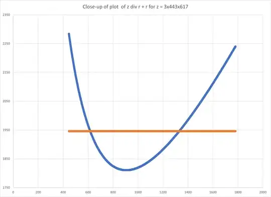

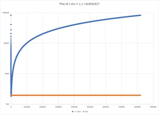

For $z = 3 \times \ 443 \times 617 = 819993$, the plot of $\lfloor {z \over r} \rfloor + r$ is given below:
Plot of z div r + r for z = 819993
Here's the closeup of the plot of $\lfloor {z \over r} \rfloor + r$ for $z = 3 \times \ 443 \times 617 = 819993$
Closeup of the plot for z = 819993
If $z$ is composite, there should be a minimal sum of divisors $a+b$ among all possible combination of divisors $a,b$ and if the conjecture is true, is the minimal $a+b$ at a bounded distance from the minimum of $\lfloor {z \over r} \rfloor + r$ that gives us an effective search procedure for $a+b$?

Conjecture C2: The minimal sum of divisors $a+b \ge \min(\lfloor {z \over r} \rfloor + r)$

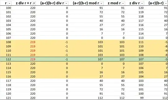

Here is some empirical data for this conjecture:
This table is for $z=12091=103\times117$. The minimum of $\lfloor {z \over r} \rfloor + r$ is $219$. The values of $r$ that give this minimum value for $\lfloor {z \over r} \rfloor + r)$ are $r \in [108,112]$. For $r = 112$, we have $z \mod r = 107$ and $GCD(107, 12091) = 107$, a non-trivial divisor of $z$.
Table for z=12091=103x117

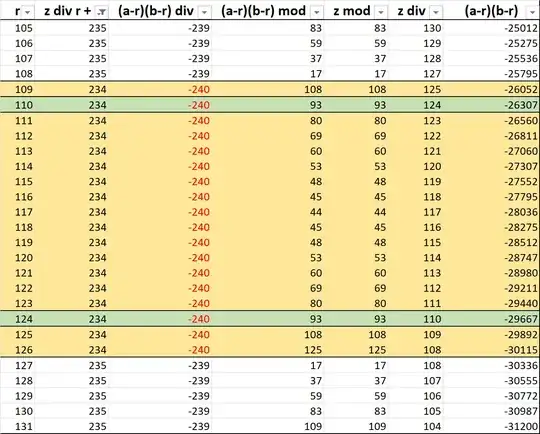

This table is for $z=13733=31\times443$. The minimum of $\lfloor {z \over r} \rfloor + r$ is $234$. The values of $r$ that give this minimum value for $\lfloor {z \over r} \rfloor + r)$ are $r \in [109,126]$. For $r \in \{110,124\}$, we have $z \mod r = 93$ and $GCD(93, 13733) = 31$, a non-trivial divisor of $z$.
Table for z=13733=31x443
