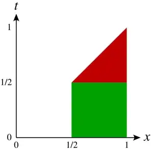

We have $$ \begin{align} \int_{1/2}^1F(x)\,\mathrm{d}x &=\int_{1/2}^1\int_0^xf(t)\,\mathrm{d}t\,\mathrm{d}x\\ &=\color{#00A000}{\int_0^{1/2}\int_{1/2}^1f(t)\,\mathrm{d}x\,\mathrm{d}t}+\color{#C00000}{\int_{1/2}^1\int_t^1f(t)\,\mathrm{d}x\,\mathrm{d}t}\\ &=\int_0^{1/2}\frac12f(t)\,\mathrm{d}t+\int_{1/2}^1(1-t)f(t)\,\mathrm{d}t\\ &=-\frac12\int_0^1t^2f(t)\,\mathrm{d}t\tag{1} \end{align} $$ since we are integrating $f(t)$ over the following region in $\mathbb{R}^2$
$\hspace{5cm}$enter image description here
Rearranging $(1)$, we have $$ \int_0^{1/2}\frac{t^2+1}{2}f(t)\,\mathrm{d}t+\int_{1/2}^1\frac{(1-t)^2+1}{2}f(t)\,\mathrm{d}t=0\tag{2} $$ Aside from a scale factor, we want to minimize $$ \int_0^1f(t)^2\,\mathrm{d}t\tag{3} $$ given $$ \int_0^1f(t)\,\mathrm{d}t=1\tag{4} $$ That means for every variation $\delta f$ so that $(2)$ and $(4)$ hold, that is, $$ \int_0^{1/2}\frac{t^2+1}{2}\delta f(t)\,\mathrm{d}t+\int_{1/2}^1\frac{(1-t)^2+1}{2}\delta f(t)\,\mathrm{d}t=0\tag{5} $$ and $$ \int_0^1\delta f(t)\,\mathrm{d}t=0\tag{6} $$ we have $(3)$ is stationary, that is, $$ \int_0^1f(t)\delta f(t)\,\mathrm{d}t=0\tag{7} $$ Orthogonality says that there must be constants $\mu$ and $\lambda$ so that $$ f(t)=\mu\cdot1+\lambda\left(\frac{t^2+1}{2}[0\le t\le1/2]+\frac{(1-t)^2+1}{2}[1/2\le t\le1]\right)\tag{8} $$ Plugging $(8)$ into $(2)$ says $$ \frac{13}{24}\mu+\frac{283}{960}\lambda=0\tag{9} $$ Plugging $(8)$ into $(4)$ says $$ \mu+\frac{13}{24}\lambda=1\tag{10} $$ Solving $(9)$ and $(10)$ gives $$ \mu=\frac{849}{4}\qquad\text{and}\qquad\lambda=-390\tag{11} $$ Plugging $(8)$ and $(11)$ into $(3)$ yields $$ \int_0^1f(t)^2\,\mathrm{d}t=\frac{849}{4}\tag{12} $$ Squaring $(4)$, to make things homogeneous, allows us to say $$ \int_0^1f(t)^2\,\mathrm{d}t\ge\frac{849}{4}\left(\int_0^1f(t)\,\mathrm{d}t\right)^2\tag{13} $$
