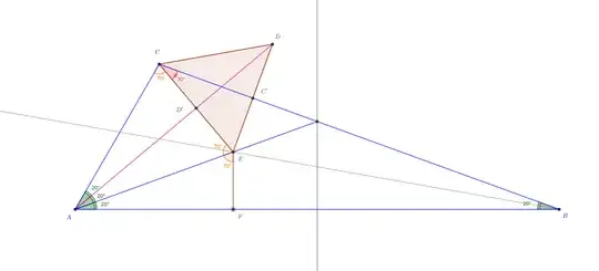

We construct on $CE$ an equilateral triangle $\Delta CDE$, so that its angle bisector in $C$ is the line $CB$. Let also in this triangle $C'$, $D'$ be the mid points of the sides opposite to $C$, $D$. Let $F$ be the projection of $E$ on $AB$.
Mathematics stackexchange problem 3795377
Then $\Delta CAE$ is isosceles having the angles in $C,E$ of the same measure, $70^\circ$, which implies $\Delta ACD'=\Delta AED'=\Delta AEF$. So $EC'=ED'=EF$.
$\square$

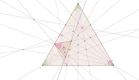

As a digression, it is maybe interesting to see in the context of the "bigger picture" of the equilateral triangle on $AB$ where are the points of the solution, e.g. the point $D$. No comment:
Problem 3795377 mathematics stackexchange

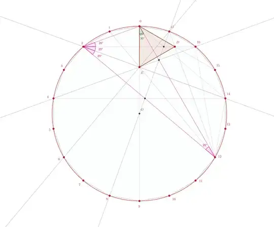

The given triangle configuration is embedded inside a regular polygon as $\Delta (0,2,12)$. We want to show that the diagonals $0-9$; $2-14$, $4-16$, $1-12$, $6-17$ are concurrent in $E$.

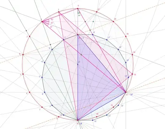

We are now performing the following transformation, that brings the regular $18$-gons from the following picture in each other:
Mathematics stackexchange 3795377 transformation
Using as center the point $9$ we use first a rotation that moves $1$ to $0$, then use a similarity which brings the length of the segment $[9,13]$ into the length of the segment $[9,12]$. Of course, we can revert the order of the rotation and homothety without change. To have a quick visual aid of the transformation, two triangles were marked. The red triangle $\Delta(9,13,1)$ is transformed into the blue triangle $\Delta(9',13',1')=\Delta(9,12,1')$. This is so because $9=9'$, $9$ being the center of the rotation and stretching, and the segment $[9,13]$ is mapped to $[9',13']=[9,12]$ since the two segments are in the right angle and the right proportion. Let us identify $1'$ as the point $E$ from the problem.
  • $9,1',0$ are colinear since both lines $90$ and $91'$ build the same angle w.r.t. $90'$.
  • So $9,(k+1)',k$ are collinear for all other values of a vertex $k$.
  • $1,1',12$ are colinear since $\angle (9,12,1)=\angle (9,13,1)=\angle (9',13',1')=\angle (9,12,1')$.
  • In a similar manner, $k,k',12$ are collinear for all other values of a vertex $k$ and transformed vertex $k'$.
  • The lines $1'-2'$ and $4-16$ coincide, this can be shown by using the line through $12=13'$, $O'$, $4'$, $4$ or the parallel line $8-8'-12$ at same distance.

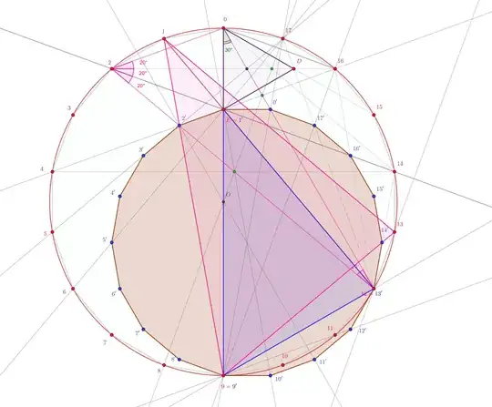

Yet an other picture. mathematics stackexchange 3795377 yet an other pic
