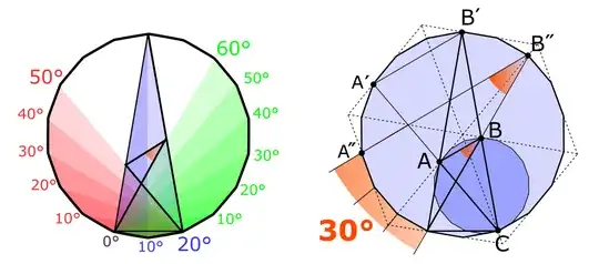

We can use the property of regular $n$-polygons, that each node sees all other nodes separated by the same angle, being $180^{\circ}/n$.
This makes the regular $18$-polygon a perfect drawing canvas for this problem, in which all angles are a multitude of $10^{\circ}$ (left image): Left: The used polygon property, right: the solution
Let’s also add a smaller $18$-polygon (right image), which:
  • has the same orientation,
  • shares $C$ as a mutual node,
  • touches two of its diagonals, in $A$ and $B$.
Due to similarity, we have that $AB \parallel A’B’$.
Since both $A’$ and $A’’ $, as well as $B’$ and $B’’$ are separated by two edges, we have that $A’B’ \parallel A’’B’’$.
Now using the mentioned polygon property, we see that $\angle A’’B’’B = 30^{\circ}$. $\quad \blacksquare$

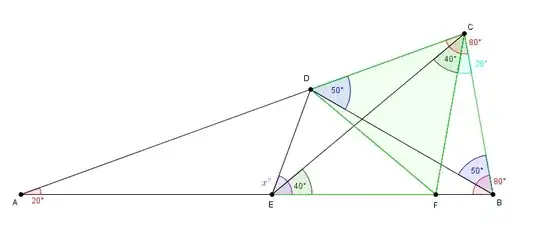

This is basically Langley's Adventitious Angles problem, a problem that first appeared in a $1922$ Mathematical Gazette, and is well known for being extremely difficult despite its simplistic appearance. Here is a nice piece by piece solution with diagrams.
For the sake of completeness, I will go ahead and add the Wikipedia solution which is attributed to James Mercer.
The idea is to construct a new point $F$ on $AB$ such that $\angle BCF=20^\circ$. After this is done, we can find all of the angles I have listed numbers for by normal angle chasing. Now, by construction we have that $\triangle BCF$, $\triangle BCD$, $\triangle CEF$ as all isosceles, so $|BC|=|CF|=|CD|=|EF|$. Additionally, by construction we have that $\angle FCD=60^\circ$, and since we have two sides the same and an appropriate angle as $60^\circ$, we know that $\triangle CDF$ is in fact equilateral! This gives us the key additional information that $|DF|$ is the same as the other lengths we have described (all outlined in green in the picture). In particular $|DF|=|EF|$, so $\triangle EFD$ is isosceles , so we have the equation $2x+40=180$, which yields the solution $x=70$.
