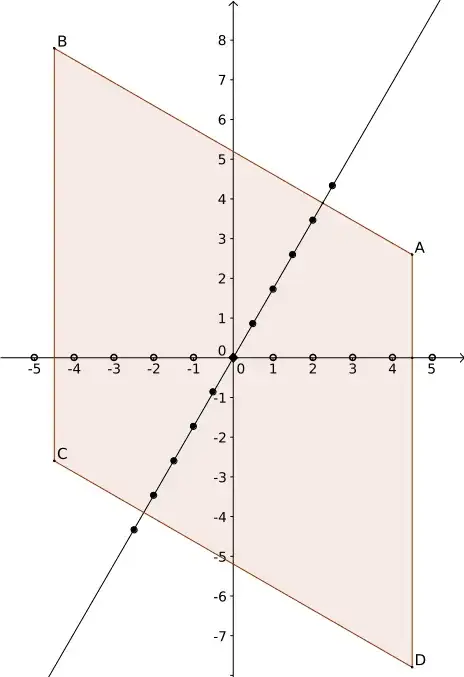

Here is an approach using the residue theorem.
The residues of $\newcommand{\res}{\operatorname*{Res}}f(z)=\pi\cot\pi z\csc^2\omega\pi z$ at its poles are: $$\res_{z=0}f(z)=\frac{1-\omega}{3};\quad\res_{z=n}f(z)=\csc^2\omega\pi n;\quad\res_{z=n/\omega}f(z)=-\omega\csc^2\omega\pi n\quad(n\in\mathbb{Z}_{\neq 0})$$ (easy to obtain using power series; we keep in mind $\omega^3=1\implies 1/\omega=-1-\omega$).
Now consider $\int_{\Gamma}f(z)\,dz$ where $\Gamma$ is the boundary of the parallelogram
$\hspace{3cm}$The contour of integration $$\big\{z : \max\{|\Re z|,|\Re(\omega z)|\}\leqslant N+1/2\big\}$$ and take $N\to\infty$. On $AB$ or $CD$ we have $z=\pm\frac1\omega\left(N+\frac12+it\right)$, with "$+$" on $CD$ and "$-$" on $AB$, and $t\in\mathbb{R}$; using $\lim\limits_{y\to-\infty}\cot(x+iy)=i$ (uniformly w.r.t. $x\in\mathbb{R}$), we see that both $\int_{AB}$ and $\int_{CD}$ tend to $$-\frac\pi\omega\int_{-\infty}^\infty\frac{dt}{\cosh^2\pi t}=-\frac2\omega$$ as $N\to\infty$. The integrals along $BC$ and $DA$ both tend to $0$, hence the residue theorem gives $$\frac{1-\omega}{3}+2(1-\omega)\sum_{n=1}^\infty\csc^2\omega\pi n=-\frac{2}{\omega\pi i}\implies\color{blue}{\sum_{n=1}^\infty\csc^2\omega\pi n=\frac{1}{\pi\sqrt3}-\frac16}.$$
