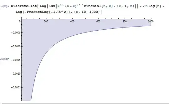

$$ \sum_{k=1}^n k^{k-1} (n-k)^{2n-k} \binom{n}{k} = n^{2n} \sum_{k=1}^n \left(\frac{k}{n}\right)^{k-1} \left(1-\frac{k}{n}\right)^{2n-k} \frac{1}{n} \binom{n}{k} $$ We can now use the fact that $$ \lim_{n \to \infty} \left(\frac{k}{n}\right)^{k-1} \left(1-\frac{k}{n}\right)^{2n-k} \frac{1}{n} \binom{n}{k} = \frac{k^{k-1}}{k!} \left( \frac{1}{\mathrm{e}^2} \right)^k $$ Thus $$ \sum_{k=1}^n k^{k-1} (n-k)^{2n-k} \binom{n}{k} \rightarrow_{n \to \infty} n^{2n} \sum_{k=1}^\infty \frac{k^{k-1}}{k!} \left( \frac{1}{\mathrm{e}^2} \right)^k = n^{2n} \left( -W\left(-\frac{1}{\mathrm{e}^2}\right)\right) = n^{2n} \exp\left( W\left(-\mathrm{e}^{-2}\right) - 2 \right) $$ where $W(z)$ denotes the Lambert $W$-function. Note that $$ \left( -W\left(-\frac{1}{\mathrm{e}^2}\right)\right) \approx 0.158594 < 0.159155 \approx \frac{1}{2\pi} $$ Numerically it seems that estimate is from above:

  • Umm, I don't see how you can replace with $\frac{k^{k-1}}{k!} e^{-2k}$ like that. Can't you apply the same logic to $S_n = \sum_{k=1}^{n} \frac{1}{k \log n}$? On the other hand, if you are talking about an upper bound... – Aryabhata Apr 17 '13 at 00:40
  • @Sasha Could you add some justification for that step? I am pretty sure your conclusion is correct however. It shows the dangers of guessing based on numerical results as my guess was really close numerically but wrong. –  Apr 17 '13 at 11:56
