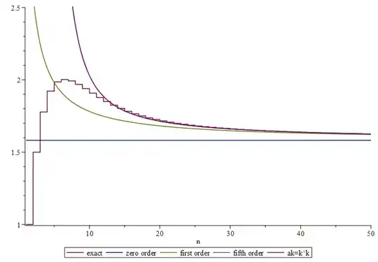

Increasing the order $K$ also shifts the range of validity to higher $n$, i.e. it is an asymptotic series. The zero, first and fifth order approximations are shown below. The fifth order is visually not distinguishable from the approximation where $a_k=k^k$ has been used for $k\geq 1$. comparison

  • Looks good. It is interesting that the coefficients $A_j$ are extremely close to $j^j$.^^ For $j=5$ the relative deviation is $7.7$ppb, unbelievably small. – Diger Mar 15 '20 at 23:00
