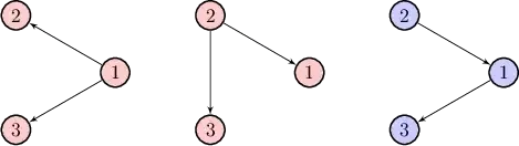

Intuitively speaking, two graphs $G$ and $G'$ are isomorphic if they have essentially the same structure (and non-isomorphic otherwise). Formally, two graphs are isomorphic if there's an edge-preserving bijection from the vertices of $G$ to the vertices of $G'$.

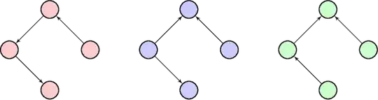

In the following example, the two red digraphs have essentially the same digraph: there is one node with two out-edges. An edge-preserving bijection (i.e., an isomorphism) in this case is $1 \mapsto 2$, $2 \mapsto 1$ and $3 \mapsto 3$.
Examples of isomorphic/non-isomorphic digraphs on 3 nodes
There is no such bijection between the red and blue digraphs since they do not have the same in/out-degree sequences.

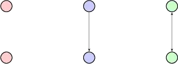

To answer this question requires some bookkeeping. The $2$-node digraphs are listed below. Note that I'm including the possibility of bidirectional edges (i.e., an edge from $A$ to $B$ and an edge from $B$ to $A$).
The non-isomorphic digraphs on 2 nodes
The number of digraphs grows quickly, and is given by Sloane's A000273. For $2$-, $3$- and $4$-node digraphs, the numbers are $3$, $16$, and $218$, respectively (allowing bidirectional edges).

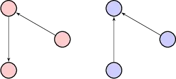

Can there be multiple graphs in the answer that have the same number of edges and the same in/ out degree totals, or does a distinct signature of edge # and in/ out degree total constitute a distinct graph?
There can be, here's an example:
Non-isomorphic digraphs with the same in-degree and out-degree sequences
and one without bidirectional edges:

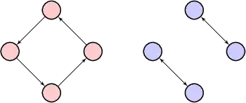

In the table in the question there's a number of omissions (this is why I'd do it on a computer).
You've correctly observe e.g. that:
Two non-isomorphic digraphs on 3 nodes
are not isomorphic, since the in/out-degrees don't match. For the same reason e.g.:
Three non-isomorphic digraphs on 4 nodes
are also non-isomorphic. Similar omissions (where we flip edge directions) happen in other cases.

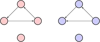

I also don't see a oriented 3-cycles with an isolated vertex.
Omissions from the list
Note: Sloane's A001174 asserts there are 42 digraphs on 4 vertices.

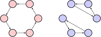

    Thank you VERY much for taking the time and attention to detail. Part of my complaint about my text stems from the fact that no examples (and no definitions) allow bidirectional edges. I'm editing my original post to state as such. – StatsViaCsh Apr 07 '13 at 20:20
    In the case where bidirectional edges are not allowed, the sequence is Sloane's A001174; and the directed $6$-cycle and the union of two disjoint directed $3$-cycles have the same in/out-degree sequence. – Douglas S. Stones Apr 07 '13 at 20:27
