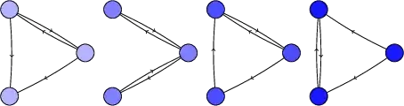

Then I wrote a script to print them, giving the 48 digraphs drawn below:
For 4-vertex 4-edge digraphs, we get these four:
This agrees with Marko Riedel's answer in these cases.
