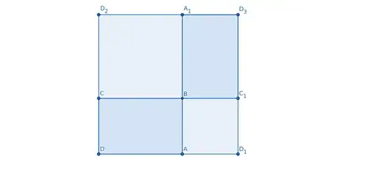

One can also start from the following axioms:
$A1$: The area of a $a \times a$ square is $a^2$.
$A2$: Any two congruent shapes have the same area.
$A3$: If a shape $R$ is disjoint union of shapes $S$ and $T$, then the area of $R$ is equal to the sum of the areas of $S$ and $T$.
With these axioms at hand one readily finds the area of a rectangle with sides $a$ and $b$: enter image description here
On the sides of the rectangle $ABCD$ build the squares $ABC_1D_1$ and $A_1BCD_2$. Let $D_3= (A_1D_2)\cap (C_1D_1)$.
Obviously the rectangles $ABCD$ and $A_1BC_1D_3$ are congruent. Therefore from our axioms one obtains: $$\begin{align} 2[ABCD]&=[DD_1D_3D_2]-[ABC_1D_1]-[A_1BCD_2]\\ &=(a+b)^2-a^2-b^2=2ab. \end{align} $$
