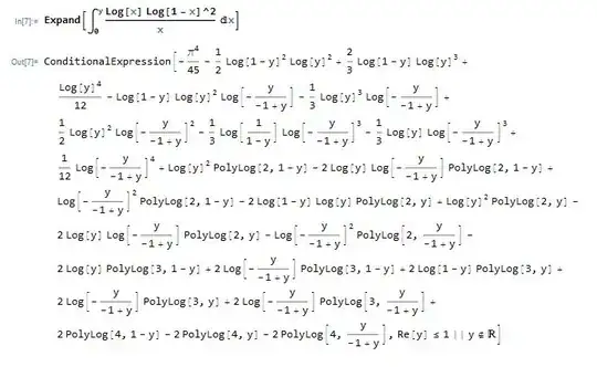

By the way, mathematica givesenter image description here

Now plug in the boundaries $0$ and $y$ then divide by $3$ we obtain that
$$\int_0^y\frac{\ln x\ln^2(1-x)}{x}dx$$ $$=\frac12\ln^2y\ln^2(1-y)-\frac13\ln^3y\ln(1-y)+\frac1{12}\ln^4(1-y)+\frac13\ln^3\left(\frac{y}{1-y}\right)\ln(1-y)\\-\ln^2\left(\frac{y}{1-y}\right)\operatorname{Li}_2\left(\frac{y}{y-1}\right)+2\ln \left(\frac{y}{1-y}\right)\operatorname{Li}_3\left(\frac{y}{y-1}\right)-2\operatorname{Li}_4\left(\frac{y}{y-1}\right)-\ln^2y\operatorname{Li}_2(y)\\+2\ln y\operatorname{Li}_3(y)-2\operatorname{Li}_4(y)+\ln^2(1-y)\operatorname{Li}_2(1-y)-2\ln (1-y)\operatorname{Li}_3(1-y)+2\operatorname{Li}_4(1-y)-2\zeta(4)$$
