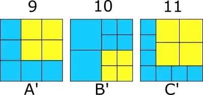

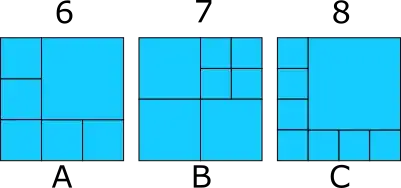

Here is a geometric solution (for $k > 5$).
The following are solutions for 6, 7, and 8 squares.
We can replace a square in each of these with four equal size squares to find a tiling with 3 more squares, so we can get 9, 10, and 11 squares. Repeating this we can get any number of squares larger than 5.
I show one iteration below:
