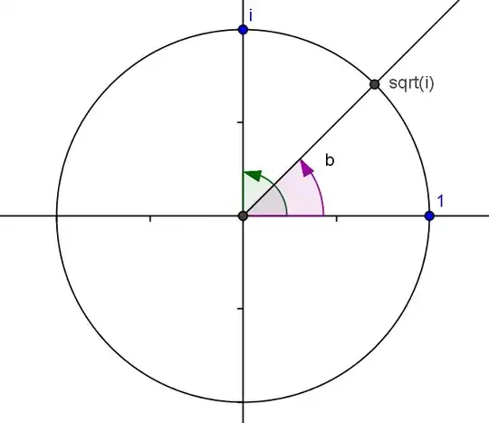

Visually, the square root of a complex number (written in polar coordinates) $(\rho,\theta)$ is the number $(\sqrt\rho,\theta/2)$.alt text

If you understand Argand diagrams (the representation of complex numbers in the complex plane) and can envision the unit circle in it, you can easily do this in your head:
-1 is 1 rotated over $\pi$ radians. The square root of a number on the unit circle is the number rotated over half the angle, so $i$, or $\sqrt{-1}$ is 1 rotated over $\pi/2$ radians. To find $\sqrt{i}$ you just half the angle again: $\pi/4$ radians. The corresponding real and imaginary parts are $\cos\frac{\pi}{4}$ and $\sin\frac{\pi}{4}$ resp.
