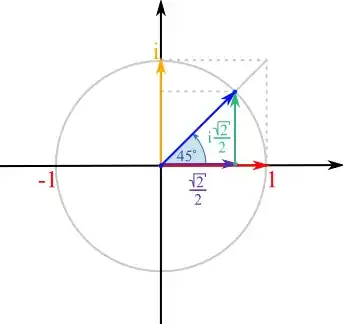

To find out what are the square roots of $i$, you need to do exactly the same thing you did up to this point: You need to find a geometric mean between $1$ and $i$. Or, in symbols:
$$1 : x = x : i$$
That is, you need to do something to your unit to get that number, and then do the same again with that number to get $i$. What operation, when applied twice, rotates by $90°$? The most obvious answer is: just rotate by half of that angle, which is $45°$, or $\frac{\pi}{4}$. You don't change the length of your unit ($i$ is also a unit long), only its direction. So the answer is a number which is your unit rotated by $45°$ and still a unit long. If you were to get it by addition, you'd have to move $\frac{1}{\sqrt{2}}$ in the direction of your unit, and then another $\frac{1}{\sqrt{2}}$ in the direction perpendicular to it (that is, in the direction of your imaginary unit $i$). So the answer in rectangular/additive form is: $\frac{1}{\sqrt{2}} + \frac{i}{\sqrt{2}}$. Or in geometry:
Square root of $i$, or fourth root of $-1$
Of course this is not the only answer! Can you find the others? ;) I'll leave it as an exercise for you. Now, when you know how it works, I'm sure you'll be able to find them.

I think this would be easier to see by writing $i$ in its polar form,
$$i=e^{i\pi/2}$$
This shows us that one square root of $i$ is given by $$i^{1/2}=e^{i\pi/4} $$

Since $$i=e^{i\pi/2}$$ then $$e^{i(\pi/4+k\pi)},\;k=0,1$$ are the two square roots of $i$.
$$\Big(\frac{i+1}{\sqrt{2}}\Big)^2=\frac{(i+1)^2}{2}=\frac{1-1+2i}{2}=i$$
