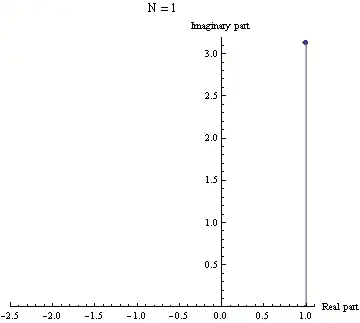

This picture helped him understand
https://i.stack.imgur.com/PZO8h.gif
user1762507
  • 495
