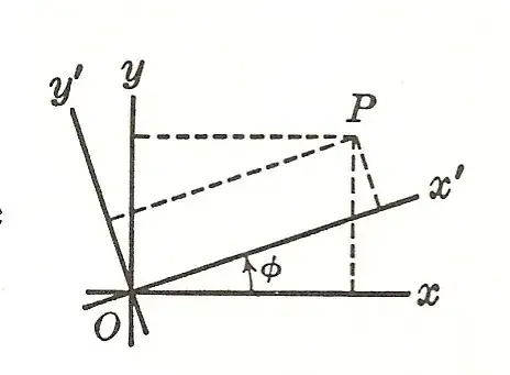

As an exercise in trigonometry.
alt text
The transformation of rectangular co-ordinates $(x,y)$ of $P$ into the rectangular co-ordinates $(x',y')$ of $P$ by a rotation of the axes is given by:
$x=x^{\prime }\cos \phi -y^{\prime }\sin \phi $
$y=x^{\prime }\sin \phi +y^{\prime }\cos \phi $.
This transformation is invertible.
Edit: This way of proving the transformation of rectangular co-ordinates does not "avoid using Euclidean geometry explicitly" (in this case trigonometry), as writen in the question.
However the same method can be used to derive the transformation of rectangular into spherical co-ordinates, which is a non-linear transformation.
