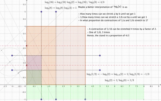

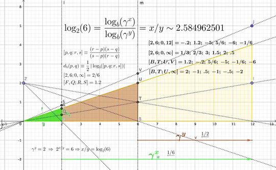

Turning the dial A of a machine by 1 notch left/right scales the area of all your objects down/up by a factor of two; similarly, dial B works by a factor of 8. Hence, 3 turns of dial A transforms the green, unit square into the orange rectangle, while 4 turns makes it into the big salmon square. How much do you need to turn dial B in order to get the green, unit square into the salmon big square? Ans: 4/3 of a notch. For more details see discussion in https://math.stackexchange.com/a/3391198/266735 and in https://insomnia.home.blog/2019/10/14/the-logarithm/.
