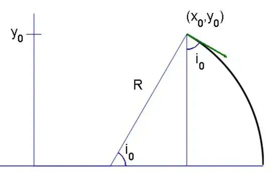

A possible answer to your question is that the quantity it measures is the length of an optical path. This optical analogy, more generally, helps to understand intuitively "why" lines (geodesics) in hyperbolic geometry are certain circles.
This analogy will be presented in the half-plane version $\mathbb{H}$ of the Poincaré hyperbolic space ($Im(z) >0$). For a description in the Poincaré disk $\mathbb{D}$ defined by ($\left|Z\right|<1$), have a look at the following recent article: (http://arxiv.org/pdf/0908.2584). A description of the correspondence between $\mathbb{H}$ and $\mathbb{D}$ can be found in an Appendix at the end of this answer.
We are going to provide a "line" in $\mathbb{H}$, i.e., a half-circle centered on the $x$ axis, a physical meaning as "natural optical path" (natural = minimal) in a medium with varying optical index (something that one can encounter in optical fibers, e.g.); the optical index we are going to take is
$$n=\dfrac{1}{y},$$
in inverse ratio with the ordinate of the current point of the trajectory.
In this medium, how can we compute the trajectory of a ray path issued from $(x_0,y_0)$ with an incidence angle $i_0$ with respect to the vertical direction (see figure) ?
Let us consider the medium as "stratified" into an infinite number of horizontal lines, each one separating two media with resp. optical indices $\dfrac{1}{y+dy}$ and $\dfrac{1}{y}$. Let us apply Snell's law :
$$\dfrac{1}{y+dy}\sin{(i+di)}=\dfrac{1}{y}\sin{(i)}.$$
or
$$\sin{(i+di)}=\left(1+\dfrac{dy}{y}\right)\sin{(i)}.$$
Let us make a first order approximation of the LHS:
$$\sin(i)+\cos{(i)} di=\sin{(i)}+\dfrac{dy}{y}\sin(i)$$
Thus
$$\dfrac{\cos{(i)}}{\sin{(i)}} di=\dfrac{dy}{y}.$$
which can be integrated as follows:
$$ln(|\sin{(i)}|)=ln(y)+K.$$
Setting $K=-ln(R)$, we obtain
$$\sin{(i)}=\dfrac{y}{R} \ \ \text{with initial setting} \ \ \sin{(i_0)}=\dfrac{y_0}{R}.$$
When you look at the picture, it is clear that
$$y=R \sin({i})$$
represents an arc of circle with radius $R$ centered on the $x$-axis, as desired.
