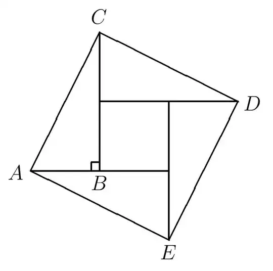

The binary function $d$ can be proven to satisfy property 6 as follows. Take any square. The displacement along one of its edges going in the counterclockwise direction has both components nonnegative. Let's call the first component of that displacement $x$ and its second component $y$. Using property 1 of the binary function $d$, we can show that the length of that edge going in that direction is $d(x, y)$. In Calculus, the area of that square can be defined as the definite integral from $-\infty$ to $\infty$ of the function that assigns to each real number $t$ the length of the intersection of the square and the line of points in $\mathbb{R}^2$ with $t$ as the first component.
This image shows that the area of the square is $(x - y)^2 + 2xy = x^2 - 2xy + y^2 + 2xy = x^2 + y^2 = (\sqrt{x^2 + y^2})^2 = (d(x, y))^2$. That proves that the binary function $d$ satisfies property 6.
