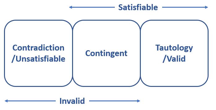

  • If tautology = satisfied for all models, then negation of tautology = not satisfied for all models. That means (I) it might be satisfied for some models but not all or (II) satisfied for no model. (I) is contingent (II) is unsatisfiable / contradiction. So negation of tautology is a set containing contingent and contradiction, but "not just contradiction". Negation of satisfable is contradiction / unsatisfiable. Otherwise, both satisfiable and tautology will mean the same. – RajS Jan 18 '19 at 20:48
  • (continued from earlier comment) I prepared this diagram. Is it correct? It also shows, negation of tautology = contingent + contradiction (but not just contradiction). – RajS Jan 18 '19 at 20:48
  • @anir The first sentence in your first comment shows a confusion; you've negated a statement about a statement, but I was talking about how the models satisfying a formula compare with those satisfying that formula's negation. Formulae are tautological when satisfied in all models, contradictions when in none, and contingent when in some but not all; and negatinga formula exchanges between the first two options. – J.G. Jan 18 '19 at 20:52
