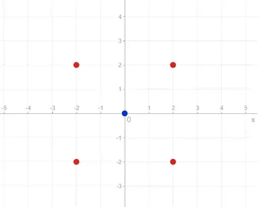

Shortly after this, I came across a question in my book that provided a picture of 4 red dots (image below) and asked, "How many ellipses do these 4 red points define". Having read the comments on my post with the circle, I thought that this was fairly straight forward.
I chose " 1 ".

Picture of 4 Red Points

In this case, assuming that the blue-painted point is the center, the points you've been given are symmetric in respect to it and thus it's like having the center and $2$ points, which is not enough to uniquely determine an ellipse.

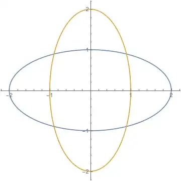

We can see this by plotting two ellipses at the same center (same $h$ and $k$), intersecting at $4$ points, with, say, semiaxes of length $1$ and $2$.
Mathematica graphics
These clearly have four points of intersection. But as soon as you know an ellipse is centered at the origin and contains any one of the four points of intersection, by the major and minor axis reflection symmetries, it contains all four. This is still true if you use generic ellipses, which can be rotated.

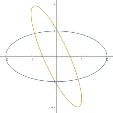

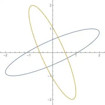

Of course, there are other ways for two ellipses to intersect at four points.
So just knowing those four points are on an ellipse cannot possibly tell you which one is intended.

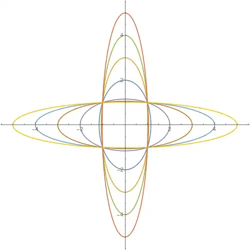

Returning to the first diagram, corresponding to the diagram you have where the four known points are the vertices of a square... Symmetries force the center of the ellipse to be the center of the square, but that's not a very strong constraint.
