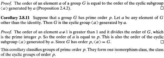

Algebra by Michael Artin Cor 2.8.11 to Lagrange's Theorem (Theorem 2.8.9).
Question: What is the relation between Cor 2.8.11 and the order of $x^k$ given by $n/{\gcd(k,n)}$ (in the text, this is in the 3rd bullet point of Prop 2.4.3)? (*)
  • I was thinking something like $1=\gcd(k,p)$ for all $1 \le k < p$, so somehow the order of the non-identity elements of a group of prime order would be shown to be $p/{\gcd(k,p)} = p/1 = p$. I think this would be a way to show Cor 2.8.11 without Cor 2.8.10 to Lagrange's Theorem (Theorem 2.8.9), Lagrange's Theorem itself (Theorem 2.8.9) or even the Counting Formula (Formula 2.8.8).
  • Or perhaps it's more the converse: that Cor 2.8.11 implies 3rd bullet of Prop 2.4.3 in the case that $n$ is prime?
(*) Prop 2.4.3
Proposition 2.4.3 Let $x$ be an element of finite order $n$ in a group, and let $k$ be an integer that is written as $k = nq + r$ where $q$ and $r$ are integers and $r$ is in the range $0 \leq r < n$.
  • $x^k = x^r$.
  • $x^k = 1$ if and only if $r = 0$.
  • Let $d$ be the greatest common divisor of $k$ and $n$. The order of $x^k$ is equal to $n/d$.

    How do you known that $ord(x) = p$, without invoking the Lagrange's Theorem? – Stefan4024 Aug 31 '18 at 17:32
  • @Stefan4024 That's my question precisely right? I was thinking to somehow use $n/{\gcd(k,n)}$ with $n=p$. I just don't know what $k$ would be here. Like somehow we might show that the orders of the non-identity elements are given by $p/\gcd(k,p)$, which of course simplifies to $p$. – BCLC Aug 31 '18 at 17:44
    That's the problem, prop.2.4.3 states: "Let $x$ be an element of finite order $n$", we all know this is going to be $p$, and that $x^k$ where $k=pq+r$ is going to have order $p$ by having to repeatedly add $r$, a $p$ amount of times on composition. But how to know all this without Lagrange, that $n>1$ has to divide $p$ and so is $p$? – Daniel Buck Aug 31 '18 at 22:05
  • @DanielBuck Right yeah. So it's perhaps more the converse: that Cor 2.8.11 implies 3rd bullet of Prop 2.4.3 in the case $n$ is prime? Thanks! – BCLC Sep 01 '18 at 06:09
    Everything after prop.2.4.3 sets up group theory: homomorphisms, isomorphisms, equivalence and partitions, until we get to cosets after which the Counting formula delivers Lagrange. We already know about cyclic groups $$ before prop.2.4.3, so in fact a fourth bullet point there could have easily allowed the special case when the $\gcd(k,p)=1$, for $p$ prime, thus implying the order of the cyclic group formed by all nonidentity elements is $p$. From here you can deduce the order of the main group, as it contains $p-1$ elements generating it! Hence you could state cor.2.8.11 here, why not? – Daniel Buck Sep 01 '18 at 09:38
    @DanielBuck Thanks! Posted answer/s. May you please check? – BCLC Sep 01 '18 at 12:19

To answer your question directly w.r.t. the direction Artin takes regarding order and Lagrange.
Well Prop.2.4.2 sets up cyclic groups, so we know, for some element $x$ in a group $G$, that taking powers of $x$ generates a cyclic subgroup of $G$, and that it is of order $n$:
$$\langle x\rangle=\{1,x,x^2,\dotsc,x^{n-1}\}\le G$$ We can say no more at this point about the relationship between $|\langle x\rangle|$ and $|G|$.
Let $x$ be an element of order $n$. Then the next proposition from Artin gives the recipe for the order of an arbitrary power of $x$, say $x^k$:
Proposition 2.4.3
Let $x$ be an element of finite order $n$ in a group $G$, and $k,q,r\in\mathbb{Z}$ s.t. $k=nq+r$, $0\le r<n$. Now
$(1)$ $x^k=x^r$
$(2)$ $x^k=1$ iff $r=0$
$(3)$ Let $d=\gcd(k,n)$. Then $\operatorname{ord}(x^k)=n/d$
Now lets see where we are immediately after Prop.2.4.3. A particular case of $(3)$ of Prop.2.4.3 in the case that $n$ is prime is immediate, even though Artin does not explicitly state it here as a corollary. For convenience let us define it as $(3a)$:
$(3a)$ Let $n=p$ be a prime. Then for $k=pq+r$, $1\le r<p$, $\gcd(k,p)=1$. Then $\operatorname{ord}(x^k)=p/1=p$
So let's see what Prop.2.4.3 gets us with this particular case of having $n=p$, i.e., when our element $x$ has the order of a prime $p$.
Well $(2)$ tells us the only power of $x$ that gives the identity is $x^0=1$, so for the set of powers $$X=\{x^0,x^1,x^2,\dotsc,x^{p-1}\}$$ we know none of $x^1$, $x^2,\dotsc,x^{p-1}$ equal $1$.
The next question is then what of the orders of $x^1$, $x^2,\dotsc,x^{p-1}$? Well $(3)$ tells us this: we know, for $1\le k\le p-1$, that $\gcd(k,p)=1$. This then gives the order of each nonidentity element $x^k$ as $\operatorname{ord}(x^k)=p/\gcd(k,p)=p/1=p$, and so each of the $p-1$ number of nonidentity elements $x^k$ generate a cyclic subgroup of order $p$, $$\langle x^k\rangle\le G$$
Now Prop.2.4.3 does not mention the actual relationship between the order of the group $G$ and the cyclic subgroups of order $p$ formed by the $p-1$ nonidentity elements of order $p$, just that they exist within it.
Upto this point Artin has not mentioned homomorphisms, isomorphisms, equivalence relations or partitions.
Now in section 2.2 Artin defines the order of a group $G$ as $$|G|=\text{ the number of elements $G$ contains.}$$ So for us $|G|=p$. Again Artin has not mentioned isomorphisms by Prop.2.4.3 so we can't talk of isomorphism classes, but again that is not what is needed for Corollary 2.8.11.
Now we must ask: can Corollary 2.8.11 be a corollary to Prop.2.4.3? Let's look at it:
Corollary 2.8.11 Suppose that $G$ has prime order $p$. Let $a\neq1$. Then $G$ is the cyclic group $\langle a\rangle$ generated by $a$.
Artin proves this by Lagrange; he states if $a\neq1$, then, by Lagrange, its order divides $|G|=p$ and so must be of order $p$ itself, since $p$ is prime, and so its cyclic subgroup generates $G$. QED.
We are coming from the other angle using what we know from Prop.2.4.3. Well we know about order, this means the number of elements in a group. We are told $G$ has order $p$, so now the question is: if $G$ has order $p$ does this mean that every nonidentity element $a$ in $G$ also has order $p$, which would then imply, without mentioning isomorphism as such, that $\langle a\rangle=G$? Remember Prop.2.4.3 only works if we know the order of the element in question, and thus far this could be anything in relation to $G$. We can't use division as Artin does as this uses Lagrange.
But what we do know is all about cyclic groups. So now we work backwards. Consider $G$, it has $p$ elements, $$G=\{a_1,a_2,\dotsc,a_p\}$$ Now let $a_1=1$, which, since $G$ is a group, the identity is unique and so no other elements are $1$. So what of the $p-1$ elements $a_2,\dotsc,a_p$? We know, by Section 2.4, that each element forms a cyclic subgroup of $G$ with order equal to the smallest integer s.t. $a_i^n=1$. So take some arbitrary nonidentity element $x$ in $G$ and consider its order $n$, with the powers of $x$ given in the set, $$X=\{x^1,x^2,\dotsc,x^{n-1},x^n=1\}$$ All we can say at the moment is that $n\leq p$. If we can deduce $n=p$ then from Prop.2.4.3 it quickly follows all nonidentity elements $a$ have order $p$, since $a$ was an arbitrary nonidentity element, and this in turn implies $\langle a\rangle=G$ since both have $p$ distinct elements, easy enough to set up a bijection here.
Now Prop.2.4.3 $(1)$ states $x^k=x^r$. So let $k=nq+r$, which by virtue of the cyclic group regenerating itself cyclically, we can take $q=0$, $1$, $2,\dotsc$, etc., to give $k=r$, $k=n+r$, $k=2n+r,\dotsc$, and so on. This generates sets of powers, each of size $n$ thus: \begin{align*} \langle x\rangle&=\{x^1,x^2,\dotsc,x^n=1\}=\{x^{n+1},x^{n+2},\dotsc,x^{2n}=1\}\\ &=\{x^{2n+1},x^{2n+2},\dotsc,x^{3n}=1\} =\dots\{x^{(j-1)n+1},x^{(j-1)n+2},\dotsc,x^{jn}=1\}=\dots\tag{1} \end{align*}
To complete the proof we look at the order of $G$ in relation to the order of the cyclic group and the repeating sets in $(1)$. Since there are $p$ elements in $G$ take an arbitrary nonidentity element $y$, then we know $y^0=y^{p}=1$, since $0\equiv p\pmod{p}$, that is the powers in the set $$Y=\{y^1,y^2,\dotsc,y^{p-1},y^p=y^0=1\}$$ cycle after every $p$th power is taken. Now the powers in $Y$ need not be distinct, so let us look at the sets in $(1)$ and assume that $n<p$. Then say it takes $j$ sets of $n$ elements to cycle through $p$ amount of elements: Note these sets only cycle through the $n$ elements in the subgroup $\langle x\rangle$ repeatedly, and not the whole of $G$, since we have assumed $n<p$. This means $jn=p$. If not, then we should have $x^p\neq1$, which implies $x^0=x^k$ for some $1\leq k< n$. But this contradicts the uniqueness of the identity, so $jn=p$ has to have $n=p$, $j=1$ and $\langle x\rangle=G$.
Therefore technically Prop.2.4.3 $(3a)$ only works if we know the order of a nonidentity element is $p$, but what we have to do first is consider the structure of the cyclic group itself, since we cannot assume that just because a group $G$ has order $p$ that any element in it actually has order $p$.
So to finish Prop.2.4.3 isn't enough on its own to imply Cor.2.11.8. Something like I have said above has to be explained first, and only then can we have Cor.2.11.8 as an actual corollary to Prop.2.4.3.
To quickly address the converse: whether Cor.2.8.11 implies $3$rd bullet of Prop.2.4.3 in the case that $n$ is prime. Cor.2.8.11 tells us every element $x\neq1$ of a group of order $p$ also has order $p$, and so they all generate $G$. We already know the order of $x^k$, for $k\ne p$, is equal to $p$ from Cor.2.11.8, and that this satisfies a particular case of the $3$rd bullet of Prop.2.4.3.
We can certainly note $\gcd(k,p)=1$, for $k\ne p$, and that the order of $x^k$ is $p$ by Cor.2.11.8, since these are precisely the nonidentity elements mentioned in Cor.2.11.8. So we can write the $3$rd bullet point in the case $|G|=p$, in the form $p/\gcd(k,p)=p$, but it doesn't imply, on its own, the actual $3$rd bullet point
so it would be more like just an observation at this stage.
