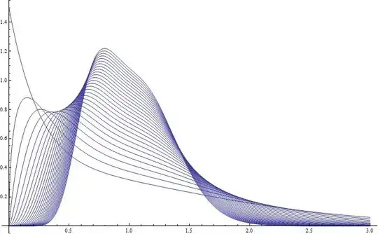

Here: \begin{eqnarray} a_m^{(p)} := \left\{ \begin{array}{rr} 3 & \mbox{if $m=1$}\\ \frac{1}{4}(-13+23 p) & \mbox{if $m=2$}\\ \frac{1}{10}(-8+7p)(-5+13 p) & \mbox{if $m=3$}\\ \frac{1}{336} (p (p (4353 p-12386)+8811)-1666) & \mbox{if $m=4$}\\ \frac{1}{336} (p (p (p (5797 p-26118)+33443)-14274)+2016) & \mbox{if $m=5$}\\ \vdots \end{array} \right. \end{eqnarray} Below we plot the spectral density for $T=3,\cdots,30$.
We also checked by Monte Carlo simulation that the closed form expression above matches well the simulation histogram.

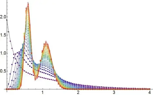

Here we provide an answer in case $n=2$. Here the underlying covariance matrix reads: \begin{equation} C = \left( \begin{array}{rr} c_{1,1} & \rho \\ \rho & c_{2,2}\end{array} \right) \end{equation} and has eigenvalues $\lambda_{1,2}=1/2\left( Tr(C) \pm \sqrt{Tr(C)^2-4 \det(C)}\right)$ .
The normalized trace of the resolvent reads: \begin{eqnarray} &&{\mathfrak g}_M(z) = \int\limits_0^{2 \pi} \int\limits_{0 < \nu_1 < \nu_2< \infty} \left[ \frac{1}{z-\nu_1} + \frac{1}{z-\nu_2} \right] \cdot \\ && \underbrace{(\nu_2-\nu_1)}_{I_1} \cdot \underbrace{{\mathfrak N}_{2,T} \frac{(\nu_1 \nu_2)^{\frac{T-3}{2}}}{(\lambda_1 \lambda_2)^{\frac{T}{2}}} e^{-\frac{T}{2} Tr\left[C^{-1} \cdot O \cdot \left(\begin{array}{rr} \nu_1 & 0 \\ 0 & \nu_2\end{array} \right) \cdot O^T \right]}}_{I_2} d\nu_1d\nu_2 \cdot d\phi \end{eqnarray}
Now, the quantity $I_2$ is the Wishart probability density function or, in other words, it is the Jacobian of the mapping $\left\{ X_{i,t} \right\}_{i=1,t=1}^{2,T} \longrightarrow \left\{ M_{i,j} \right\}_{1\le i \le j \le 2}$ from the returns to the elements of the sample covariance matrix. On the other hand the quantity $I_1$ is the Jacobian of the mapping $\left\{ M_{i,j}\right\}_{1\le i \le j \le 2} \longrightarrow \left\{\nu_1,\nu_2;\phi\right\}$ from the elements of the sample covariance matrix to the eigenvalues and to the angle that determines the eigenvectors. Here \begin{equation} O:=\left( \begin{array}{rr} \cos(\phi) & -\sin(\phi) \\ \sin(\phi) & \cos(\phi)\end{array}\right) \end{equation}
Now, a simple calculation shows the following: \begin{eqnarray} &&Tr\left[C^{-1} \cdot O \cdot \left(\begin{array}{rr} \nu_1 & 0 \\ 0 & \nu_2\end{array} \right) \cdot O^T \right] = \\ &&\frac{1}{2} \frac{Tr(C)}{\det(C)}(\nu_1+\nu_2) - \frac{1}{2}\frac{(c_{1,1}-c_{2,2})}{\det(C)}(\nu_1-\nu_2) \cos(2 \phi) - \frac{1}{2} \frac{2\rho (\nu_1-\nu_2)}{\det(C)} \sin(2 \phi) \end{eqnarray} Since the above quantity is the only quantity in the integrand that depends on the angle integrating over that angle can be readily done by using Itzykson-Zuber integral over orthogonal groups and leads to the following: \begin{eqnarray} &&{\mathfrak g}_M(z) = {\mathfrak N}_{2,T} (2 \pi) \cdot \\ &&\int\limits_{0 < \nu_1 < \nu_2 < \infty} \frac{1}{2} \left[ \frac{1}{z-\nu_1} + \frac{1}{z-\nu_2}\right] \cdot (\nu_2-\nu_1) \cdot \frac{(\nu_1 \nu_2)^{\frac{T-3}{2}}}{(\lambda_1 \lambda_2)^{\frac{T}{2}}} \cdot e^{-\frac{T}{4} \cdot \frac{Tr(C)}{\det(C)} \cdot (\nu_1+\nu_2)} \cdot I_0\left( (\nu_2-\nu_1) \frac{T}{4} \frac{\sqrt{Tr(C)^2 - 4 \det(C)}}{\det(C)} \right) d\nu_1 d\nu_2 \end{eqnarray} where $I_0()$ is the modified Bessel function of zeroth order.
Now, in order to proceed further we take the inverse Stieltjes transform to get the spectral density. In this process the fractions in the square brackets in the integral over the eigenvalues above turn into Dirac delta functions as follows $1/(z-\nu_\xi) \longrightarrow \delta(z-\nu_\xi)$ for $\xi=1,2$. These Dirac delta functions annihilate one of the integration variables and we end up with two one dimensional integrals. We have: \begin{eqnarray} &&\rho(z) = \frac{{\mathfrak N}_{2,T}}{2(\lambda_1 \lambda_2)^{\frac{T}{2}}} z^{(T-3)/2} e^{\left( -\frac{T}{4} \frac{\lambda_1+\lambda_2}{\lambda_1 \lambda_2} z\right)}\cdot \\ && \left( \int\limits_0^z (z-\nu) \nu^{(T-3)/2} e^{-\frac{T}{4} \frac{\lambda_1+\lambda_2}{\lambda_1 \lambda_2} \nu} I_0\left( (z-\nu) \frac{T}{4} \frac{\lambda_1+\lambda_2}{\lambda_1\lambda_2}\right) d\nu + \int\limits_z^\infty (\nu-z) \nu^{(T-3)/2} e^{-\frac{T}{4} \frac{\lambda_1+\lambda_2}{\lambda_1 \lambda_2} \nu} I_0\left( (\nu-z) \frac{T}{4} \frac{\lambda_1+\lambda_2}{\lambda_1\lambda_2}\right) d\nu \right) \end{eqnarray} Now by using the integral representation of the Bessel function we evaluated the integrals above in "closed form". Firstly we define: \begin{eqnarray} &&f_> (m,z,A,B):=\\ && e^{-A z} \sum\limits_{p=0}^m \frac{m!}{p!} z^p (-1)^{m-p} \sum\limits_{m_2=0}^{\lfloor \frac{m-p}{2} \rfloor} \binom{m-p-m_2}{m_2} \binom{-1/2}{m-p-m_2} \frac{(2 A)^{m-p-2 m_2}}{(A^2-B^2)^{1/2+m-p-m_2}}\\ &&f_\infty(m,z,A,B):=\frac{m!}{2\pi} \int\limits_0^{2 \pi} \frac{e^{z B \sin(\tau)}}{(A+B \sin(\tau))^{m+1}}d\tau \end{eqnarray} and then we have: \begin{eqnarray} &&\rho(z) = \frac{{\mathfrak N}_{2,T}}{2(\lambda_1 \lambda_2)^{\frac{T}{2}}} z^{(T-3)/2} e^{\left( -\frac{T}{4} \frac{\lambda_1+\lambda_2}{\lambda_1 \lambda_2} z\right)}\cdot \\ &&\left(\right.\\ &&\left. z f_\infty(\frac{T-3}{2}, z, \frac{T}{4} \frac{\lambda_2+\lambda_1}{\lambda_1 \lambda_2},\frac{T}{4} \frac{\lambda_2-\lambda_1}{\lambda_1 \lambda_2}) - f_\infty(\frac{T-1}{2}, z, \frac{T}{4} \frac{\lambda_2+\lambda_1}{\lambda_1 \lambda_2},\frac{T}{4} \frac{\lambda_2-\lambda_1}{\lambda_1 \lambda_2})+ \right.\\ && 2f_>(\frac{T-1}{2}, z, \frac{T}{4} \frac{\lambda_2+\lambda_1}{\lambda_1 \lambda_2},\frac{T}{4} \frac{\lambda_2-\lambda_1}{\lambda_1 \lambda_2})-2 zf_>(\frac{T-3}{2}, z, \frac{T}{4} \frac{\lambda_2+\lambda_1}{\lambda_1 \lambda_2},\frac{T}{4} \frac{\lambda_2-\lambda_1}{\lambda_1 \lambda_2})\\ &&\left.\right) \end{eqnarray}
Below I plot the spectral densities for $T=3,5,7,\cdots,103$ (Violet, Blue all the way through to Red). We have: enter image description here
Here $(\lambda_1,\lambda_2)=(0.60735,1.10567)$ .
