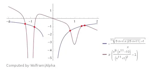

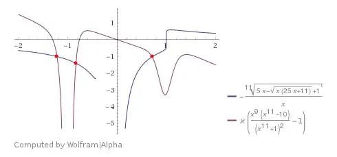

  2. The algebraic system solution. $$\begin{cases} -1/xg'(1/x) + y + x = 0\\[4pt] x\dfrac{1-10(xy)^{11}}{(1+(xy)^{11})^2} = 1, \end{cases}$$ $$\begin{cases} y = 1/xg'(1/x) -x\\[4pt] x^{22}y^{22}+2(5x+1)x^{11}y^{11} - x+1 = 0, \end{cases}$$ $$\begin{cases} y = x^{10}\dfrac{x^{11}-10}{(1+x^{11})^2} - x\\[4pt] \left[ \genfrac{}{}{0}{0} {y = \dfrac1x\sqrt[11]{-5x-1 - \sqrt{(25x+11)x}}} {y = \dfrac1x\sqrt[11]{-5x-1 + \sqrt{(25x+11)x}}.} \right. \end{cases}$$ The graphic solutions for the "negative" branch are in the Plot1.
    Plot1
    The graphic solutions for the "positive" branch are in the Plot2.
    Plot2
    There are not solutions with $y> -0.704459.$ So the highest value of $LSH(2)$ are in the boundary of the domain definition.
