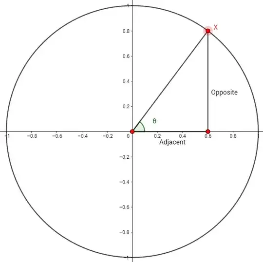

I'll try to answer this:
I don't see why anything involving imaginary numbers is a matter of trigonometry.
What is $\sin\theta$ and $\cos\theta$? You may have learned that, for a right triangle, one must have:
$$\sin \theta = \frac{opposite}{hypothenuse} \quad \quad \cos \theta=\frac{adjacent}{hypothenuse}$$
Here comes an interesting question: Do $\sin\theta, \cos\theta$ depend only on the angle of the triangle or do they depend on the lengths of the sides of the triangle? The answer is that they depend only on the angle $\theta$ (why?). This have the following meaning: I can simplify things a little bit just taking all triangles with $hypothenuse=1$ which are similar to the the triangle I am measuring $\sin\theta, \cos\theta$ originally, and then I'll get:
$$\sin \theta = \frac{opposite'}{1}= opposite' \quad \quad \cos \theta=\frac{adjacent'}{1}=adjacent'$$
Now, if we translate this triangle to the origin, we'll have:
Now we know what is $\sin \theta$ and $\cos \theta$. The coordinates of the point $X$ must be $(\cos \theta, \sin \theta)$. Now, we are using an idea: There is a "basis" and we are expressing points as multiples of the elements of this basis. This means that:
$$X=(\cos \theta, \sin \theta)= \cos \theta (1,0) + \sin \theta (0,1)$$
What is this "basis"? It is a set with elements which can not be constructed with any combination of the other elements. Look at the figure, intuitively, you can't reach that point only walking upwards, you need to be able to walk to the right too. It means that you can't go to the right walking to the top and vice-versa. If I want to reach that point, I need to walk $\cos \theta$ upwards and then $\sin \theta$ to the right. Each element of the basis can't be constructed with the other, this is called "linear independence". Isn't this similar to complex numbers? A complex number is a number of the form:
$$z=a+bi$$
In which you can't get $a$ by multiplying $i$ by some real number and vice-versa. This means that we also have a basis here, we just need to switch $(1,0)$ by $1$ and $(0,1)$ by $i$:
$$X=\cos \theta (1,0) + \sin \theta (0,1)=\cos \theta (1) + \sin \theta (i)=\cos \theta + i \sin\theta $$
Obviously, it's not as simple as that: We must also show that geometry done with multiples of $\{(1,0),(0,1)\}$ is the same of geometry done with multiples of $\{1,i\}$, as it turns out, they are usually defined to be very closely related. We could have done the same with polynomials of degree $\leq1$ too, for example:
$$X=\cos \theta (1) + \sin \theta (x)=\cos \theta + i \sin\theta x$$
But the most interesting case would be the case in which these polynomials can give you a geometry fairly similar to the geometries of the other cases I mentioned. Why did they went to a geometry of multiples of $\{(1,0),(0,1)\}$ to a geometry of multiples of $\{1,i\}$? Because the complex numbers have a lot of pleasing properties which - perhaps - you couldn't have derived the other way around. If we "translate" the geometry from one kind of basis to another, you gain every interesting property they have and also, you can find a translation from this pleasing property to the previous system you were working with! Now ask yourself: What properties were gained from this "translation"?
