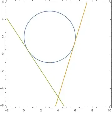

For your example, we have $h=3$, $k=2$, $r=3$ and $\mathbf p=[4:-5:1]$, giving $[3:\pm\sqrt{41}:-5\sqrt2]$ for the unit circle tangents and finally $$\begin{bmatrix}3 & \pm\sqrt{41} & -5\sqrt2\end{bmatrix} \begin{bmatrix}1&-7&11\\7&1&-23\\0&0&15\sqrt2\end{bmatrix} = \begin{bmatrix}3\pm7\sqrt{41} & -21\pm\sqrt{41} & -117\mp23\sqrt{41}\end{bmatrix}$$ as the solution to the problem. These lines and the circle are plotted below:
This method works for ellipses as well if you use a non-uniform scaling and modify $\xi$ and $\eta$ accordingly. If the ellipse isn’t axis-aligned, then you might need to add another rotation before scaling, but the basic method is the same.
