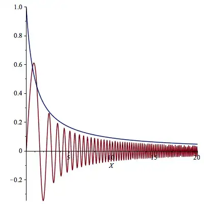

    Experimenting numerically, it seems that $\left\lvert\int_0^X[\cos(x^2)-\sin(x^2)], dx\right\rvert \le C(1+X)^{-1}$: see this plot – Giuseppe Negro Oct 31 '17 at 20:37

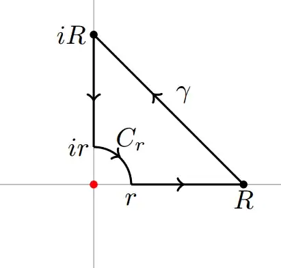

Consider the following function
$$f(z)=z^{-1/2}\,e^{iz}$$
Where we choose the principal root for $ z^{-1/2}=e^{-1/2\log(z)}$. By integrating around the following contour
enter image description here $$\int_{C_r}f(z)\,dz+\int_{r}^R f(x)\,dx+\int_{\gamma}f(z)\,dz+\int^{iR}_{ir}f(x)\,dx = 0$$
Taking the integral around the small quarter circle with $r\to 0$ $$\left| \int_{C_r}f(z)\,dz\right|\leq \left|\sqrt{r}\int^{\pi/2}_{0}e^{it/2} e^{rie^{it}}\,dt\right| \leq \sqrt{r}\int^{\pi/2}_{0}\left|e^{-r\sin(t)}\right|\,dt\sim 0$$
On $\gamma(t)=(1-t)R+iRt$ where $0\leq t \leq 1$
$$\left|\int_{\gamma}f(z)\,dz\right| = \left| R(i-1)\int^1_0e^{-1/2\log(R(1-t)+iRt)}e^{i(1-t)R-Rt}\,dt\right| \\ \leq \frac{\sqrt{2}}{\sqrt{R}} \int^1_0 \frac{e^{-Rt}}{\sqrt[4]{(1-t)^2+t^2}}\,dt$$
Hence we have
$$\left|\int_{\gamma}f(z)\,dz\right| \leq \frac{\sqrt{2}}{\sqrt{R}} \int^1_0 e^{-Rt}\,dt=\frac{\sqrt{2}}{R\sqrt{R}}\left(1-e^{-R}\right)\sim_{\infty}0$$
Finally what is remaining when $r\to 0$ and $R \to \infty$
$$\int^\infty_0 \frac{e^{ix}}{\sqrt{x}}\,dx =i \int^{\infty}_{0}(ix)^{-1/2}e^{-x}\,dx$$
Note that $i^{-1/2}=e^{-i\pi/4}$
$$\int^\infty_0\frac{e^{ix}}{\sqrt{x}}\,dx = ie^{-i\pi/4}I = \frac{I}{\sqrt{2}}+i\frac{I}{\sqrt{2}}$$
By equating the real part with the real part and the imaginary part with the imaginary part we reach $$\int^\infty_0\frac{\cos(x)}{\sqrt{x}}\,dx =\int^\infty_0\frac{\sin(x)}{\sqrt{x}}\,dx = \frac{I}{\sqrt{2}} $$
Although $I$ is easy to evaluate using the gamma function, we didn't have to evaluate it to show equivalence.
