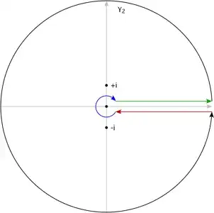

I'm trying to evaluate the integral of $\frac{z^{\frac{1}{3}}}{(z+1)^2}$ on the following keyhole contour. enter image description here
I am using the branch cut of $[0, \infty)$.
In the solutions to this question, it is said that along the green line we can write $z=xe^{0 i}$ and along the red we can write it as $z=xe^{2 \pi i}$.
Can someone explain why this is so? I'm having a hard time understanding why, because the green and red line avoid the branch cut, and hence the arguments aren't actually $0, 2\pi$ respectively.
I'm also struggling to understand a branch cut for $z^a$ for $a$ not an integer. My understanding is that it is any line joining $0$ and '$\infty$', as these are the branch points. Could someone explain why these are the branch points?

    in the limit where you get infinitly close to the branch cut with your contour the argument is indeed $0$ or $2\pi$ – tired Apr 21 '17 at 17:12

From the previous discussion, we know that $z^{1/3}$ has logarithmic branch points at $z=0$ and $z=\infty$. We choose to cut the plane along the positive real axis.
With this choice of branch cut, if we approach a point on the positive real axis along a contour in the first quadrant, then $\arg(z)$ approaches $0$. If we approach a point on the positive real axis along a contour in the fourth quadrant, then $\arg(z)$ approaches $2\pi$.
Referring to the diagram in the OP, we can formally parameterize the green (red) segments as $z=x \pm i\epsilon$, $x\in [\sqrt{\nu^2-\epsilon^2},\sqrt{R^2-\epsilon^2})$, where $\nu>0$ is the radius of the blue-colored circular arc centered at the origin and $R$ is the radius of the gray-colored circular arc. Then, we have
\begin{align} \lim_{\epsilon\to 0}\int_{\sqrt{\nu^2-\epsilon^2}}^{\sqrt{R^2-\epsilon^2}}\frac{(x+ i\epsilon)^{1/3}}{(x+ i\epsilon+1)^2}\,dx&=\int_\nu^R \frac{x^{1/3}}{(x+1)^2}\,dx\\\\ \lim_{\epsilon\to 0}\int_{\sqrt{\nu^2-\epsilon^2}}^{\sqrt{R^2-\epsilon^2}}\frac{(x- i\epsilon)^{1/3}}{(x- i\epsilon+1)^2}\,dx&=\int_\nu^R \frac{x^{1/3}e^{i2\pi/3}}{(x+1)^2}\,dx \end{align}

It can be shown that as $\nu\to 0$ and $R\to \infty$, the contributions from the integrals around the circular arcs vanish. This leaves
$$\begin{align} (1-e^{i2\pi/3})\int_0^\infty \frac{x^{1/3}}{(x+1)^2}\,dx&=2\pi i \text{Res}\left(\frac{z^{1/3}}{(z+1)^2},z=-1\right)\\\\ &=2\pi i\lim_{z\to -1}\frac13z^{-2/3}\\\\ &=\frac{2\pi i}3 e^{-i2\pi/3} \end{align}$$
Solving for
$$\int_0^\infty\frac{x^{1/3}}{(x+1)^2}\,dx=\frac{2\pi}{3\sqrt{3}}$$
