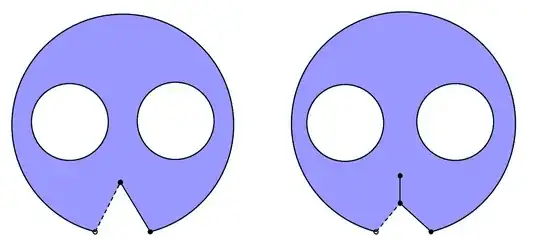

Zipping up halfway gives a continuous bijection from your pants with the fly down to your pants with the fly at half mast and this is not a homeomorphism. However, the two spaces are homeomorphic no?
pants
One can well-imagine this phenomena persists for various other "manifolds with tears" - even in higher dimensions.
