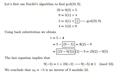

In order to find an inverse of a congruence, do we have to go through Euclid’s algorithm and do back substitution?
Here is an example to find an inverse of 9 modulo 23. enter image description here

  • @fleablood Does your final answer is 18? If so, then there maybe some mistakes in your method. The inverse should be 8. – yashirq Nov 24 '16 at 00:50
  • Why do you think it should be 8? All the answers so far universally (!including the one in the text!) say it is -5 = 18. 9x-5 = -45 = 1 mod 23 and 9x18 = 162 = 723 + 1 = 1 mod 23. But 87 = 72 = 3 mod 23. I think I'm right. – fleablood Nov 24 '16 at 01:07
  • Oh no, my mind is still in another question $8400^{-1}(mod 11}$. My bad. But the inverse is already given in the example, which is -5. Isn't it the unique one? – yashirq Nov 24 '16 at 01:10
  • -5 and 18 are both the same thing mod 23. $-5 \equiv 18 \mod 23$. Likewise any $23k -5 \equiv -5 \equiv 18 \mod 23$ would be acceptable. [-5] and [18] are considered to be the same thing. By convention one usually wouldn't choose to say "the answer is 4342" although it is true that 1/9 = 4342 = -5 mod 23. For sake of clarity one puts the answer in smallest terms. Sometimes it's convenient to do the smallest positive value, 18, as I did. Or sometimes the smallest absolute value, -5, as everyone else did. But -5 and 18 are considered the same as 23 -5 = 18. So, yes, that is a unique answer. – fleablood Nov 24 '16 at 18:16

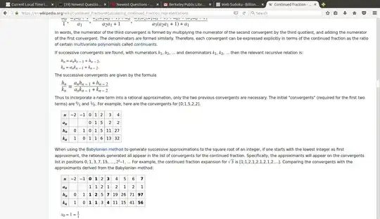

Found a place where the wikipedia article shows convergents the way I like to write them:
