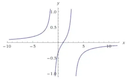

A homeomorphism (continuous bijection with a continuous inverse) would be $f:(0,1)\to\Bbb R$ given by $$f(x)=\frac{2x-1}{x-x^2}.$$
Added: Let me provide some explanation of how I came by this answer, rather than simply leave it as an unmotivated (though effective) formula and claim in perpetuity.
Many moons ago, I was assigned the task of demonstrating that the real interval $(-1,1)$ was in bijection with $\Bbb R.$ Prior experience with rational functions had shown me graphs like this:
Rational Graph
The above is a graph of a continuous function from most of $\Bbb R$ onto $\Bbb R.$ This doesn't do the trick on its own, since it certainly isn't injective. However, it occurred to me that if we restrict the function to the open interval between the two vertical asymptotes, we get this graph, instead:

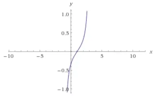

Restricted Rational Graph
This graph is of a continuous, injective (more precisely, increasing) function from a bounded open interval of $\Bbb R$ onto $\Bbb R.$ This showed that rational functions could do the job. Other options occurred to me, certainly (such as trigonometric functions), but of the ideas I had (and given the results I was allowed to use) at the time, the most straightforward approach turned out to be using rational functions.

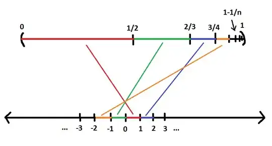

For a less differentiable example, consider the bijection in the following picture, enter image description here
In symbols, given $x \in (0,1)$ let $n$ be the largest natural number such that $1-\frac{1}{n}<x$, define $$y=\frac{x-n}{\frac{1}{n}-\frac{1}{n+1}}$$ to be the renormalized version of $x$ if the interval $(1-\frac{1}{n},1-\frac{1}{n+1}]$ is rescaled and shifted to map to $(0,1)$. Then we have the following bijection: $$f(x)=\begin{cases}\frac{n-1}{2}+y,& n \text{ odd} \\ -\frac{n-2}{2}-y,& n \text{ even}\end{cases}$$
