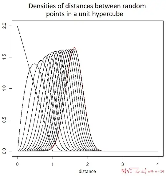

The actual densities are not simple analytically, but the following graph uses numerical convolution and integration to illustrate the densities for the distance when $n=1$ to $16$ and also shows in red the normal approximation when $n=16$.
For large $n$ the variance of the distance stays close to $\frac{7}{120}$ making the standard deviation about $0.24$. For example, with an $n=2500$ dimensional unit hypercube, the distance can be anything from $0$ to $50$ but in the large majority of cases it will be between $20$ and $21$ and in all but a vanishingly tiny proportion of cases it will be between $19$ and $22$. In data analysis, this curse of dimensionality means there can be relatively little difference in the distances between different pairs of random samples.
