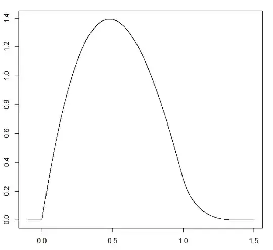

So that exercise gives the cumulative distribution function for $D$ as requested in the question. While we are looking at this we may as well also find the density for $D$ by taking the derivative, which is
  • $2d^3-8d^2+2\pi d$ when $0 \le d \le 1$
  • $-2d^3+8d\sqrt{d^2-1}-8 d \tan^{-1}\left(\sqrt{d^2-1}\right)+(2\pi-4) d$ when $1 \le d \le \sqrt{2}$
  • $0$ when $d \le 0$ or $\sqrt{2} \le d$
and looks like this, very like one of the density curves I drew in answer to another question using numerical techniques
