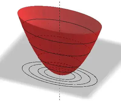

The above derivation certainly works, but I find it somewhat unsatisfactory because the partial derivatives appear out of nowhere at the end. Here’s a somewhat informal geometric argument in which they enter naturally. In the non-degenerate cases we care about, the equation $z=Q(x,y)$ represents an elliptic or hyperbolic paraboloid (depending on the sign of the principal minor of $A_Q$).
In the first case, consider a paraboloid of revolution. If we fix $z$, the resulting level curve is a circle, and varying $z$ generates a family of concentric circles. The center $(x_c,y_c)$ will be at the vertex of the paraboloid, which is a local extremum of $z=Q(x,y)$, hence $\nabla Q(x_c,y_c)=0$. We can obtain any elliptic hyperboloid from this surface by applying an affine transformation, which preserves ratios of distances along the same line and intersections of lines, so the resulting family of ellipses will also be concentric.

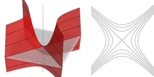

enter image description here For the second case, the level curves form a family of hyperbolas with common asymptotes, so their center is at the intersection of these lines as we noted above. When the plane $z=k$ passes through the saddle point of the surface, we get the degenerate hyperbola consisting of the two asymptotes, and they intersect at the saddle point. So, the center of this family of hyperbolas is also at the point $(x_c,y_c)$ where $\nabla Q(x_c,y_c)=0$.
