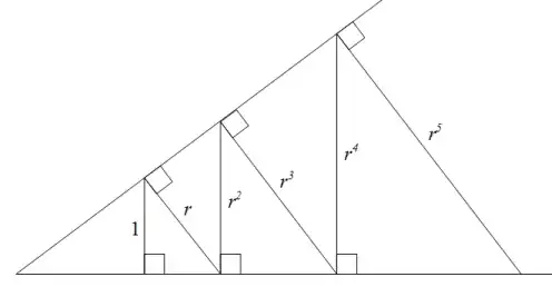

In your case, you can choose $P$ and $Q$ such that their ratio is equal to $2$. When the ratio is constant, it is called a geometric series (as answered here). As a reminder, it is a sum of terms in geometric progression (se.math) like $1,r,r^2,r^3,\ldots$, whose name (the geometry part) is illustrated by the following figure:
