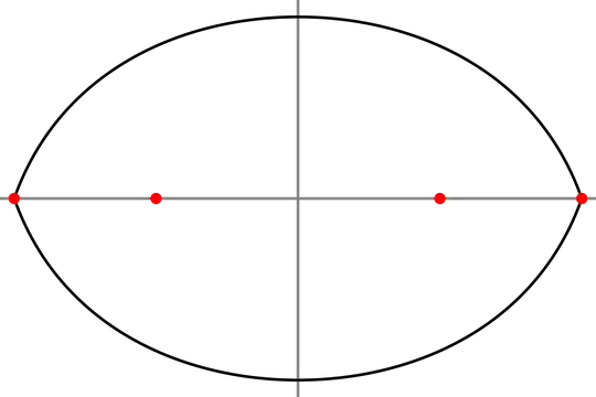

As mentioned in the comments, the locus of points whose sum-distance to n given points is constant is called an n-ellipse.
The image shows a 4-ellipse; without loss of generality, we can scale the figure so that B and C are at $(\pm1,0)$ (and A and D at $(\pm a,0)$), then ignore the part of the rope stretched across BC so that $l=\mathsf{AE+BE+CE+DE}$. The locus of E is the locus of intersection of two ellipses centred on the origin:
  • One has foci B and C and axes $k$ and $\sqrt{k^2-1}$
  • The other has foci A and D and axes $m$ and $\sqrt{m^2-a^2}$, with $2(k+m)=l$ $$\frac{x^2}{k^2}+\frac{y^2}{k^2-1}=1; \frac{x^2}{m^2}+\frac{y^2}{m^2-a^2}=1$$
After some algebraic manipulation we find $$x^2=\frac{m^2k^2(m^2-a^2-k^2+1)}{m^2-a^2k^2}$$ $$y^2=\frac{(k^2-m^2)(m^2-a^2)(k^2-1)}{m^2-a^2k^2}$$ Since manipulating all this would be too tedious, take $a=2$ and $l=8$ as an example. The expressions reduce to $$x^2=\frac{(4-k)^2k^2(13-8k)}{16-8k-3k^2}$$ $$y^2=\frac{(8k-16)(12-8k+k^2)(k^2-1)}{16-8k-3k^2}$$ Let $X=x^2$ and $Y=y^2$. The resultant of $X(k)$ and $Y(k)$, the curve's implicit equation, is quintic in X and Y: $$-6720X^5 + (-42688Y + 524160)X^4 + (-104128Y^2 + 2625248Y - 13608000)X^3 + (-123456Y^3 + 4595473Y^2 - 50494240Y + 139856640)X^2 + (-71680Y^4 + 3405920Y^3 - 55511328Y^2 + 349444224Y - 591252480)X + (-16384Y^5 + 911616Y^4 - 19293696Y^3 + 188524800Y^2 - 792115200Y + 870912000)=0$$ And here is a pretty plot of this curve, with the red dots at $(\pm1,0)$ and $(\pm2,0)$: Plot of the 4-ellipse; looks like an eye
Now for the main part of my answer: it is not possible to find the area bounded by this curve analytically, whether by parametric equation or resultant, because the equations for x and y alone contain a square root within them that prevents the use of integration techniques for rational functions, and because the quintic expression in X and Y is not solvable. What I would do to find its area numerically is the following:
  • For many positive values of x, find the corresponding y-value (which will also be positive)
  • Use the points sampled to estimate the area of the curve in the first quadrant
  • Since the curve is symmetric about the x- and y-axes, multiply the estimate by 4 to get the total area
Doing so with the above curve yields a result of 7.614914 (to 6 decimal places).
