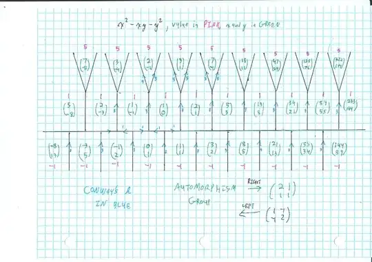

As you can see, the $x$ values are the odd index Fibonacci numbers, and the $y$ values are the even index Fibonaccis. The formal way to get from one solution $(x,y)$ to the next larger is $$ (x,y) \mapsto (2x+y, x+y). $$ As the determinant of the automorphism matrix is $1$ and the trace $3,$ we use Cayley-Hamilton to get separate $$ x_{n+2} = 3 x_{n+1} - x_n, $$ $$ y_{n+2} = 3 y_{n+1} - y_n. $$
The same information is contained and explained in Conway's Topograph diagram for this quadratic for $x^2 - xy- y^2.$ I drew this picture for my answer at Solve the following equation for x and y: where it was used for $x^2 - xy - y^2 = 5.$ In today's problem we found $x^2 - xy - y^2 = 1.$
