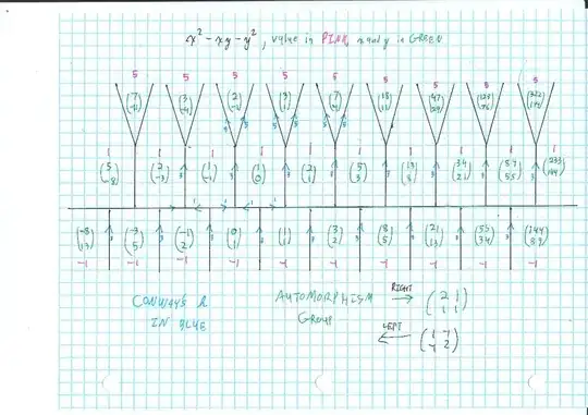

I like Conway's graphical method for these, the quadratic form is $f(x,y) = x^2 - xy- y^2,$ and we are looking for the value $5.$ As you can see, these happen when $y,x$ are consecutive Lucas numbers, $x$ is the larger one. I will need to look this up, there is something about odd/even indices as well. Alright, looked it up, the solutions with natural numbers are $$ x = L_{2n}, \; \; y = L_{2n-1}; \; \; \; \; \; \; n \geq 1 $$
See chapter 1 in http://www.maths.ed.ac.uk/~aar/papers/conwaysens.pdf
Let's see, Conway likes the letter $h$ for the little blue numbers labelling edges, the arrow points in the direction of increasing form value. He likes $a,b$ for the values, and two values $a,b$ on either side of an edge $h$ denote the quadratic form $a x^2 + h x y + b y^2$ or $a x^2 - h x y + b y^2$ which is "equivalent" to the original. Our original is $x^2 - xy - y^2$ as that arrow points left, we see that $x^2 + xy - y^2,$ $x^2 + 3xy + y^2,$ and $x^2 + 5 xy + 5 y^2$ are equivalent to that. So is $5 x^2 + 5 xy + x^2.$
Conway does not generally draw in the $x,y$ coordinates of a point, i did that in green. Conway prefers to write those as vectors $e_1$ or $e_2.$ My way is done in another book, by Stillwell. Finally, neither author forces the diagram to show the automorphism group, but, for MSE, that seems an important aspect.
What is traditionally called the automorphism group of the quadratic forms tells us that if we have a solution $x^2 - x y - y^2 = 5,$ then we get another one from $$ (2x+y, x+y). $$ This is the matrix product $$ \left( \begin{array}{cc} 2 & 1 \\ 1 & 1 \end{array} \right) \left( \begin{array}{c} x \\ y \end{array} \right) = \left( \begin{array}{c} 2x+y \\ x+y \end{array} \right) $$ The matrix $$ A = \left( \begin{array}{cc} 2 & 1 \\ 1 & 1 \end{array} \right) $$ has determinant $1,$ and trace $3.$ So, Cayley-Hamiltion says $$ A^2 - 3 A + I = 0, $$ or $$ A^2 = 3 A - I . $$ This tells us that, if we put the solutions $(x_n, y_n),$ we have $$ x_{n+2} = 3 x_{n+1} - x_n, $$ $$ y_{n+2} = 3 y_{n+1} - y_n $$ as identities in the separate variables. these lead quickly to confirmation of the Lucas property.
Will Jagy
  • 139,541
  • Brilliant... Thoroughly enjoyed the Conway paper – buzaku Feb 04 '15 at 02:21
  • I can't seem to figure out where are the $a$ and $b$ values in your picture. If all the blue numbers are the $h$ for the $hxy$ part in the quadratic, and the pink numbers are the values of $x^2 - xy - y^2$ when you plug in the green numbers as the $x$ and $y$ values, how do you obtain the $a$ and $b$ values from this picture? – mr eyeglasses Feb 04 '15 at 16:01
  • Also how did you find $(2x + y, x +y)$ (and subsequently the matrix $\begin{bmatrix} 2 & 1\ 1 & 1 \end{bmatrix}$)? – mr eyeglasses Feb 04 '15 at 16:19
  • @user130018 $a,b$ are the pink values, on opposite sides of an edge which will be labelled $h.$ The form depicted is $a x^2 + h x y + b y^2.$ There is a certain degree of ambiguity, it might be $a x^2 - h xy + b y^2.$ Or, by rotating the picture, $b x^2 + h xy + a y^2.$ Glad you are trying to work this out. – Will Jagy Feb 04 '15 at 18:29
  • @user, wesee a little identity matrix, one column vector in green with entries 1,0; with pink value 1. Below it and slightly left, a column with entries 0,1; value -1. Put the columns side by side in the correct oreder you get an identity matrix. Move immediately to the right, we see a column 2,1, with value 1; below it, column 1,1, value -1. I really should have drawn in the little blue arrow pointing left, that shows that this is the first perfect copy of the original form (with blue $h$ arrow pointing the same way). Put the two column vectors side by side in the proper order, you get it. – Will Jagy Feb 04 '15 at 18:36
