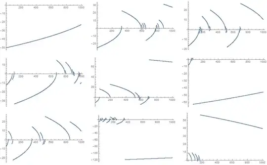

  • The map is chaotic on the real line. All orbits are unstable, and the map is highly sensitive to initial conditions. Here are the first 1000 iterations starting from each of $4.000001$ to $4.000009$:

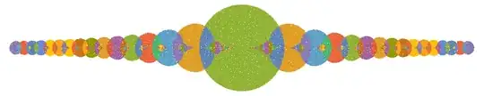

  • Before doing that, any trajectory can jump in and out of the unit circle arbitrarily often. If I colour the complex plane depending on the "inside-outside" pattern of the trajectory, I get a nifty fractal of deformed circles covering the real axis (repeated colours are due to a limited palette):
