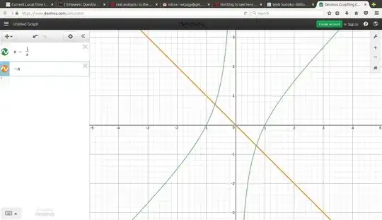

Note that there is a 2-cycle if we begin with $$ x = \pm \frac{1}{\sqrt 2} \approx \pm 0.7071, $$ as we then get $$ x - \frac{1}{x} = -x. $$ $$ f(x) = x - \frac{1}{x}. $$ Important: $f$ is odd, $$ f(-x) = -f(x). $$ $$ \mbox{If} \; \; \; f(x) = -x, \; \; \; \mbox{then} \; \; \; f(f(x)) = x.$$

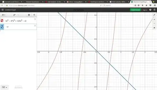

We also get 4-cycles at the roots of $$ 2 x^4 - 4 x^2 + 1, $$ as then $$ f(f(x)) = -x, $$ $$ \mbox{If} \; \; \; f(f(x)) = -x, \; \; \; \mbox{then} \; \; \; f(f(f(f(x)))) = x.$$
The presence of cycles of larger and larger degree tends to support the hypothesis of chaotic behavior elsewhere.

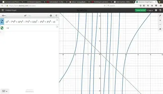

6-cycles at the roots of $$ 2x^8 - 11x^6 + 17x^4 - 8x^2 + 1 $$ $$ \mbox{If} \; \; \; f(f(f(x))) = -x, \; \; \; \mbox{then} \; \; \; f(f(f(f(f(f(x)))))) = x.$$ Now that I think of it, this diagram also shows some 3-cycles. enter image description here
Seems to me that these points involved in $2k$-cycles might be dense in the real line. If so, that would be strong evidence.
