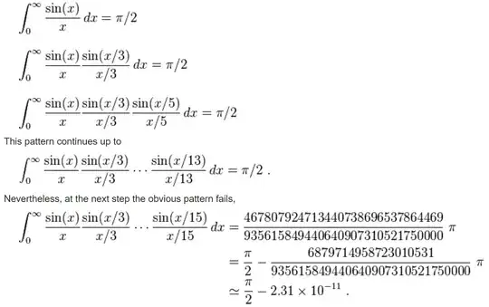

$$\int_0^{\infty } \left(\prod _{k=0}^7 \frac{\sin \left(\frac{x}{2 k+1}\right)}{\frac{x}{2 k+1}}\right) \, \mathbb{d}x= \frac{\pi}{2} - \frac{6879714958723010531}{935615849440640907310521750000} \pi $$
However, I can't determine how to prove it.

In 2001, the Borwein Brothers surprised their readers with the trick you referred to: The Borwein integrals, and their unexpected break-down The pattern suggests that the definite integral of the sinc function ($=\pi/2$), does not alter when this sinc is multiplied with other sincs having lower frequencies. But unexpectedly, they show that the eighth integral is about one billionth of a percent smaller. How is that possible?

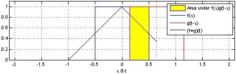

  5. The convolution of two equivalent block pulses (equal width), results in a triangular function (an isosceles): the left and right corner of the rectangle are completely eroded (see animation below), but the center of the plateau is preserved (which btw explains why $\int_0^{\infty} \operatorname{sinc}(x)^2 dx = \frac{\pi}{2}$ (see: integralOfSquaredSincs))
Animation of convolving two boxcars
Source: Convolution

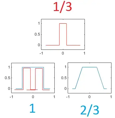

With this theory in mind, let's look at the second Borwein Integral. The product of the first two sincs, is equivalent to convolving a rectangle having unit width (image below, left lower graph) with a (1/3)-kernel (upper graph in the middle). The result is a trapezoid, in which only two third of the initial unit plateau width is preserved, and one third is eroded:
Convolving the unit block with the 'one-third' box
​Why? Because in the interval [-1/3, 1/3], the (1/3)-kernel was completely embedded within the unit block. Just outside this domain, however, an increasing part of the kernel is not 'matched', resulting in two downward slopes moving out of the center. However, since the center of the initial plateau is not (yet) affected, the second Borwein integral equals still $\frac{\pi}{2}$.

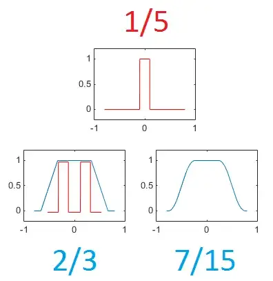

In the third Borwein integral, the resulting trapezoid is convolved with an (1/5)-kernel, which takes away another 20% of the original plateau width. Therefore the new residual plateau is reduced to 1 - 1/3 - 1/5 = 7/15 part of the initial plateau width:
Convolving the convolution product with the one-fifth box

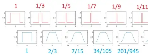

With each new convolution, the residual plateau gets smaller and smaller:
Convolving all the smaller boxes
​*(which is not that well visible, because each convolution also 'smoothens' the outcome, exactly how the probability distribution of a coin flipping experiment gets smoother when more coins are flipped)*
Not enough plateau left to completely match the (1/15)-kernel
Once the outcome of the (1/11)-convolution in turn is convolved with the (1/13)-kernel, the residual plateau equals: $1 - \frac{1}{3}-\frac{1}{5}-...-\frac{1}{13}= \frac{2021}{45045}<\frac{1}{15}$ which is for the first time smaller than the next convolution kernel.
So for the eighth Borwein integral, the remaining plateau is too small to completely match the (1/15)-kernel in the center, resulting in a slightly lower integration outcome for the main frequency component.
