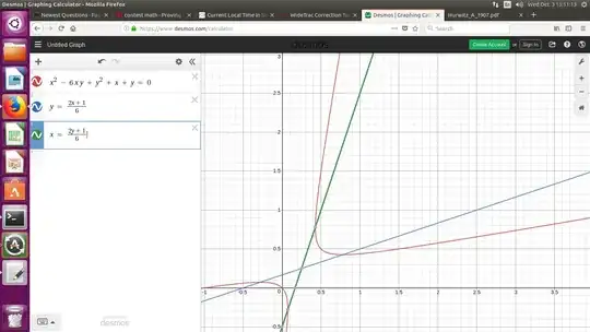

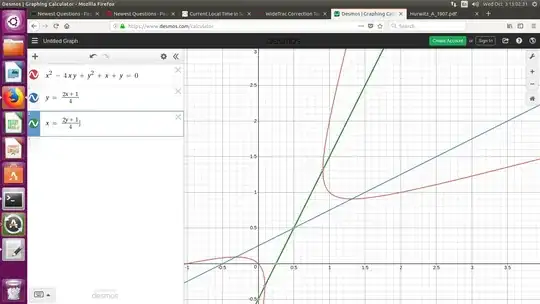

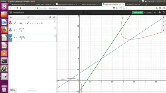

Never noticed this one. The viewpoint from Hurwitz (1907) is that there are solutions only if there are "fundamental" solutions. In this case, that would be integer points $(x,y),$ both positive, with $$ x^2 - kxy+y^2 + x + y = 0, $$ $$ y \geq \frac{2x+1}{k}, $$ $$ x \geq \frac{2y+1}{k}. $$ I will include some pictures. This is possible only if $$ \frac{2k+4 + \sqrt{4k^3+8k^2}}{2k^2-8} \geq 1 \; . $$
So, actually $$ k = 3,4. $$ As indicated in answers and comments, for $k=3$ we get consecutive terms in the sequence $$ x_{j+2} = 3 x_{j+1} - x_j - 1, $$ beginning $$ 2, 2, 3, 6, 14, 35, 90, 234, 611, 1598, \cdots $$
For $k=4$ we get consecutive terms in the sequence $$ x_{j+2} = 4 x_{j+1} - x_j - 1, $$ beginning $$ 1, 1, 2, 6, 21, 77, 286, 1066, \cdots $$

enter image description here enter image description here enter image description here enter image description here
