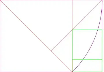

Euclid's algorithm (originally formulated using repeated subtractions rather than divisions) can be applied to any pair of comparable quantities (two lengths, two masses, two frequencies): just keep subtracting the smaller of a pair from the larger and then replace the larger one by the difference found; stop when the difference becomes $0$, returning the smaller (which is now also the larger) retained quantity as GCD. Although I haven't actually read Euclid, I would be surprised if the original formulation wasn't actually in terms of geometric lengths, given that Greek mathematicians were more at ease with geometry than with numbers. The only caveat is that with lengths it is not an algorithm in the sense that it is guaranteed to terminate; two lengths are by definition "commensurable" if the procedure does terminate, and it then returns the largest unit of length for which both intitial lengths are integer multiples. One can easily show (without using any arithmetic) that the procedure does indeed never terminate (because one gets back to the original ratio of lengths, but at a smaller scale) when starting with the lengths of a side and a chord of a regular pentagon (giving the golden ratio) or for a side and a diagonal of a square (ratio $1:\sqrt2$); this is a nice exercise in geometry.
Pentagon $\qquad$ A4 paper
Now if you apply this to rational numbers, you see there is no problem, since they can be compared, subtracted, and any pair of them is necessarily commensurable (one over the product of the denominators gives common measure, though not necessarily the largest one). Bringing both rational numbers to this common denominator, one sees that the formula you guessed is indeed the correct one. If you have prime factorizations of $a,b,c,d$ available, you can also find the $\gcd(\frac ab,\frac cd)$ by taking every prime number $p$ to a power that is the minimum of the valuations of $p$ in $\frac ab$ and in $\frac cd$, where the valuation in $\frac ab$ is its multiplicity in $a$ minus its multiplicity in $b$ (a possibly negative integer). However your formula combined with Euclid's algorithm for integers (or directly Euclid's algorithm for rational numbers) is a more efficient method of computing.
