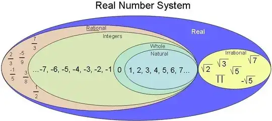

I wouldn't have asked this question if I hadn't seen this image:
From this image it seems like there are reals that are neither rational nor irrational (dark blue), but is it so or is that illustration incorrect?

    Notice that there are no numbers depicted in the blue area. – Hagen von Eitzen Sep 14 '15 at 17:27
  • 70
    It is not a very clever illustration, indeed. – uniquesolution Sep 14 '15 at 17:27

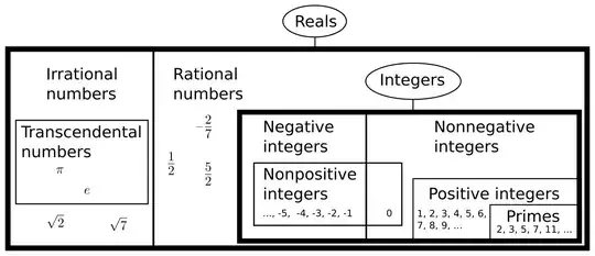

A real number is irrational if and only if it is not rational. By definition any real number is either rational or irrational.
I suppose the creator of this image chose this representation to show that rational and irrational numbers are both part of the bigger set of real numbers. The dark blue area is actually the empty set.
This is my take on a better representation:
Subsets of real numbers
Feel free to edit and improve this representation to your liking. I've oploaded the SVG sourcecode to pastebin.

    @Dominik a great answer (I especially like how you smartly omitted the [ambiguous] $N$ set), with one small remark from me - the distinction of "primes" is a little bit confusing, because you provide those exemplary numbers twice, once in positive ints, and a second time in "primes" - and that makes the picture a bit confusing, because you don't repeat e.g. $\pi$ in $IQ$ outside of transcendentals... maybe I'm not making myself completely clear, but I hope you know what I mean. –  Sep 15 '15 at 19:38
    @vaxquis I know what you mean and I've thought about this when I made the image. I decided to write those numbers twice so that it is obvious where the sequence $1, 2, 3, 4, \ldots$ comes from [it might be confusing if the primes are missing]. One possible solution for this could be to write the positive integers as a sequence and then make some lines that show that the primes are in the same set ["teeth" above a rectangle that says "primes"]. But I simply thought that the current representation looks nicer. – Dominik Sep 15 '15 at 19:45
    Aren't there infinitely more irrational numbers than rational? The diagram seems to imply something different. Although it is nice in other ways. Similarly, I think there are infinitely more transcendental numbers than algebraic ones. –  Sep 15 '15 at 20:15
    @Lembik: Yes, the diagram doesn't convey cardinalities good at all. But to do this, one would have to make all sets equally big, except for the set of transcendental numbers. This set would have to be some orders of magintude bigger. This just doesn't translate well into a graphic. – Dominik Sep 15 '15 at 20:19
    @Lembik Yes, in fact, all of the boxes except "transcendental numbers" should be exactly the same size ($\aleph_0$), and "transcendental numbers" ($\mathfrak{c} = 2^{\aleph_0}$) should be infinitely larger than all the rest put together. – zwol Sep 15 '15 at 20:22
    In your new diagram, there may be integers that are neither positive nor nonpositive! :P – user253751 Sep 15 '15 at 23:05
  • Ideas for an extension that handles some more oddballs among the reals: $\text{real root of }x^5-x+1$ is algebraic but has no closed form. $\Omega$ (Chaitin's constant) is non-computable, but well-defined. $0.78391434\stackrel{?}{\dots}$ (a specific "random" real number) is undefinable. – Lynn Sep 16 '15 at 02:12
  • @zwol: How can the transcendental set be larger than the irrational set which contains it? – MichaelS Sep 16 '15 at 04:38
    @MichaelS because the image is wrong. The transcedental set is the "biggest" of them all. – Jakob Sep 16 '15 at 07:57
  • @zwol No, the set of irrational numbers is also uncountable. – Daniel R Sep 16 '15 at 14:02
  • @Jakob The image is correct, the set of irrational numbers is also uncountable. – Daniel R Sep 16 '15 at 14:02
  • @Jakob If I'm reading irrational and transcendental numbers correctly, Irrational is the slightly "larger" set, almost all of which are also Transendental. The non-transcendental irrationals being the Algebraic Numbers (examples of which are shown outside the transcendental set above) and which are countable. Probably the Transcendentals and Algebraic numbers should be shown as side-by-side subsets of the Irrationals, as is done for irrationals/rationals as subsets of reals. – TripeHound Sep 16 '15 at 14:09
  • @Dominik I really like the "teeth" idea, that's about what I had in mind as a possible solution. –  Sep 16 '15 at 14:32
  • @MichaelS I meant the size of the irrational-but-not-transcendental box. The algebraics are still countable. (And of course the "reals" box still contains everything.) – zwol Sep 16 '15 at 15:27
  • @TripeHound This won't work, as all rational numbers are algebraic. The algebraic numbers would have to span the rationals, some irrationals, be disjoint to the transcendental numbers and still the irrationals would have to consist of the transcendental numbers and a subset of the algebraic numbers. I don't think it's really feasible to cram all this information into a single diagram. – Dominik Sep 16 '15 at 15:27
  • @Dominik On reflection, I think I agree, the diagram would be harmed by trying to scale everything to cardinalities. – zwol Sep 16 '15 at 15:29

No. The definition of an irrational number is a number which is not a rational number, namely it is not the ratio between two integers.
If a real number is not rational, then by definition it is irrational.
However, if you think about algebraic numbers, which are rational numbers and irrational numbers which can be expressed as roots of polynomials with integer coefficients (like $\sqrt2$ or $\sqrt[4]{12}-\frac1{\sqrt3}$), then there are irrational numbers which are not algebraic. These are called transcendental numbers.

Irrational means not rational. Can something be not rational, and not not rational? Hint: no.

Every real number is either rational or irrational. The picture is not a good illustration I think. Though notice that a number can not be both irrational and rational (in the picture intersection is empty)

The set of irrational numbers is the complement of the set of rational numbers, in the set of real numbers. By definition, all real numbers must be either rational or irrational.
