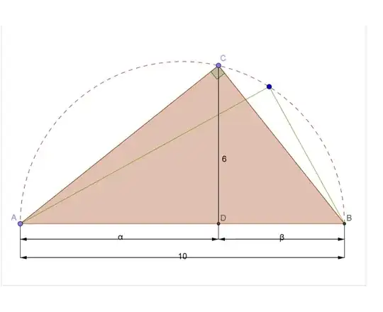

113
There are many ways to prove that such triangle does not exist. I am using a different approach.
Suppose that the said right angled triangle can be formed. Then, we are interested in where should the foot of the said altitude (CD) be? [That is, how far is D (on AB) from A (or from B)?]
We assume that D is $\alpha$ and $\beta$ units from A and B respectively.
Clearly, we have $\alpha + \beta = 10$ …… (1)
Also, by a fact on right angled triangles, we have $\alpha \beta= 6^2$ ……… (2)
EDIT : That fact is "Power of a point".
To find $\alpha$ and $\beta$ is equivalent to solving the quadratic equation $x^2 – 10x + 36 = 0$.
Since the discriminant $(= [-10]^2 - 4 \times 36)$ is negative , we can conclude that such roots ($\alpha$ and $\beta$) are not real.
Mick
  • 17,141
    how did you generate such a nice diagram? – Fattie Dec 31 '15 at 15:17
    @JoeBlow Using Geogebra. Image is then sent to WORD via the clipboard. After re-sizing, the adjusted image is then sent to PC Paintbrush for the final touch. It (*.png) is then uploaded. – Mick Dec 31 '15 at 18:05
  • Geogebra. Amazing, you mean you did it right there online Brilliant, thanks for that – Fattie Dec 31 '15 at 18:10
    i am really confused, it is clear thta $alpha+beta=10$ but how did yyou find $\alpha \beta=6^2=36$ i mean what geometry did you used to get eq(2)? – Bhaskara-III Dec 31 '15 at 18:12
  • @JoeBlow It can be downloaded as a standalone s/w. Then, you have ample of time to edit your picture. – Mick Dec 31 '15 at 18:13
    @Bhaskara-III Any right-angled triangle with an altitude so formed is being cut into a total of 3 triangles. These 3 triangles are similar to each other. Setup the corresponding ratios to find out the said relation. – Mick Dec 31 '15 at 18:18
  • i really don't know that. please can you show me how to find that? – Bhaskara-III Dec 31 '15 at 18:21
    i know similar triangles but how to get $\alpha\beta=6^2$ from your picture? – Bhaskara-III Dec 31 '15 at 18:23
    @Bhaskara-III Try to read http://www.mathwarehouse.com/geometry/similar/triangles/geometric-mean.php – Mick Dec 31 '15 at 18:43
  • in your picture, diameter of circle is $AB=10$ then why did show that altitude is $CD=6$? – Bhaskara-III Jan 01 '16 at 14:26
    @Mick: it could be better if you represent altitude $CD$ by some variable say $x$. If you take directly $CD=6$ in a semi-circle of diameter $10$ then the point $C$ should not lie on the periphery it should lie outside the periphery. See the answer by Michael Chirico. He has nicely represented all the outside points by a red line in the picture. – Bhaskara-III Jan 01 '16 at 14:34
    @Mick: In you picture, point $C$ must lie outside the periphery because you take $CD=6$. point 'C' must not lie on the periphery of semicircle. I think picture representation by Michael Chirico is better than yours. – Bhaskara-III Jan 01 '16 at 14:50
  • @Bhaskara-III I think you are not quite familiar with “proof by contradiction”. It goes like this:- 1) We ‘assume’ the construction is possible first. 2) Then, we try to show such assumption contradicts some known facts. 3) From that, we conclude that such construction is not valid. – Mick Jan 01 '16 at 16:11
  • @Bhaskara-III As I have mentioned in the beginning that there are many ways. It depends on whether a quick result is needed or a formal vigorous proof is required. There is no need to discuss this any further. – Mick Jan 01 '16 at 16:42
    Picture by Michael Chirico clearly shows that such a right triangle not exits while your picture is showing that such a triangle is constructed. it is also a contradiction between these two pictures here. – Bhaskara-III Jan 01 '16 at 16:46
  • FWIW, the two legs of this impossible right triangle have length $\sqrt{10(5\pm i\sqrt{11})}$ – PM 2Ring Jan 02 '16 at 13:08
  • @PM2Ring Yes. I know that the quadratic equation is solvable into complex roots. But can those values for lengths be expressible as *real* units with respect to our everyday physical measuring instruments? – Mick Jan 02 '16 at 14:38
  • @Mick: Of course not! :) FWIW, I wasn't implying any criticism of your excellent answer (which I've up-voted, BTW), I just wanted to add that info for the benefit of other readers, and your answer seemed an appropriate place to put it, since you mention the relevant quadratic. – PM 2Ring Jan 02 '16 at 14:48
  • Actually, I just noticed that it's possible to simplify those roots. :oops: $\sqrt{55} \pm i\sqrt{5} \approx 7.4161984871 \pm 2.2360679775i$ – PM 2Ring Jan 02 '16 at 15:05
  • @PM2Ring Thanks for the encouragement. – Mick Jan 02 '16 at 15:15
  • "by a fact on right angled triangles" ... might be more useful to someone if you make it "by the Power of a Point Theorem"? – quintopia Jan 03 '16 at 07:38
  • I think it would be just easier to see that the maximum that the altitude can be is the radius of this circle, that is 5 in this case. – Aritra Das Jan 06 '16 at 08:01
    @AritraDas As I have mentioned in the beginning, there are many ways to prove.... I think this prove (by contradiction) is equally convincing. – Mick Jan 06 '16 at 10:21

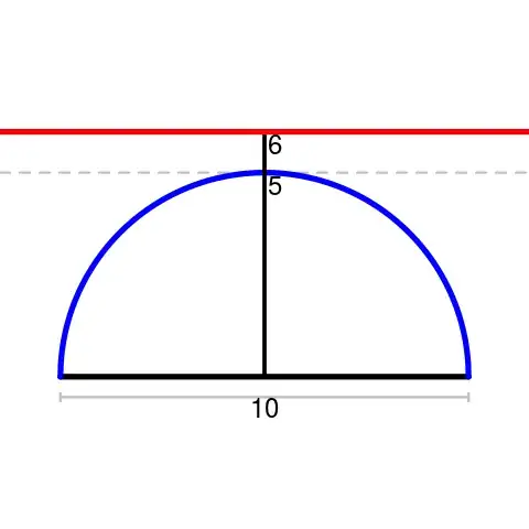

98
The red line represents all possible third vertices for triangles with base 10 and height 6;
The blue curve represents all possible third vertices for right triangles with hypotenuse 10.
The two sets have null intersection.
(in fact, the maximum possible third angle 6 units away is $\arccos(\frac{11}{61})\approx$ 79.6°)
(and yes, technically we should include the corresponding points below the segment as well)
    I think your answer (along with all other answers, with the exception of the one by @AlanCampbell) has badly misinterpreted the problem. The problem statement says that the altitude "dropped onto the hypotenuse" -- not the one from dropped from the vertex with the right angle -- is 6 inches. Thus, the triangle has sides 6, 8, and 10 inches -- there's no problem at all with such a triangle existing... – Mico Jan 04 '16 at 06:15
    @Mico though I agree it's apparent the author should have been more careful with verbiage, I disagree with you for hair-splitting reasons. the problem states "the altitude"; in the 3-4-5 case it becomes immediately ambiguous as there are in fact three altitudes with an end on the hypotenuse. thinking this way, there is no way the author could get away with using the definite article. the only way we can take the problem as given is to deduce the author in fact meant the altitude corresponding to the right angle. – MichaelChirico Jan 04 '16 at 06:23
    @Mico: what do you think the 'the altitude "dropped onto the hypotenuse"' is intended to mean? As far as I am concerned it is the exact same thing as 'the one from dropped from the vertex with the right angle.' In any triangle there are three altitudes. Each can be specified by either the side on which they are dropped or by the vertex from which the are dropped (or still differently). – quid Jan 04 '16 at 20:03
  • I'll add that this could well be a quibble that is simply something lost in translation (I take it the original quote was in Russian?)... we need a native Russian speaker to comment on whether, in the original Russian, this ambiguity existed in the first place. Until the ambiguity is confirmed in the original Russian, this is simply a poor translation. – MichaelChirico Jan 04 '16 at 20:13
  • @MichaelChirico you're too kind; I followed exactly the same train of thought as you, except I attributed the odd grammar to either a poor translation or a non-native speaker doing the best they could. This subconscious hypothesis was reinforced by the odd syntax/ambiguity in the "as had their Russican peers" statement. – pjz Jan 04 '16 at 21:17

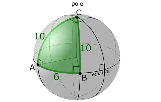

43
Non-Euclidian triangle on a sphere
Here a non-Euclidian answer to the question
The depicted sphere has a circumference of length 40, and thus a radius of $\frac{20}{\pi}$. The points $A$ and $B$ are located on the equator, and $C$ is located on a pole.
Now $\triangle ABC$ is a right triangle (it even has two right angles), since all meridians intersect the equator perpendicularly.
Define $AC$ to be the hypothenusa, with length $10$. The height, being the shortest distance from $B$ to its hypothenusa $AC$ is then indeed $6$. As $\triangle ABC$ covers $\frac6{40}$ of the upper hemisphere, its area is:
$$A_{\text{triangle}} = \frac{6}{40}\times\frac{1}{2}\times 4\pi r^2 = \frac{120}{\pi}$$
$\blacksquare$
Job Bouwman
  • 1,859

Let $\Delta ABC$ be our triangle, $\measuredangle ACB=90^{\circ}$ and $CD$ be an altitude of the triangle.
Thus, by AM-GM $$6=CD=\sqrt{AD\cdot BD}\leq\frac{AD+BD}{2}=\frac{10}{2}=5,$$ which is a contradiction, which says this triangle does not exist.
Let $ABC$ be a right angled triangle with hypotenuse $AC=10$, base $BA=y$(say) and perpendicular $CB=x$ (say). Drop perpendicular $BD=6$ (if it exists) on $AB$. It is easy to see that $\Delta ABC\sim \Delta ADB$ then using ratios,
$$\frac{z}{y}=\frac{6}{x}=\frac{y}{10}$$
From last two ratios, $xy=60$
Also $x^2+y^2=10^2$ as $ABC$ is right angled at $B$.
This gives $$x^2+\left(\frac{60}{x}\right)^2=100$$ or $$x^4-100x^2+3600=0$$ which has no real roots.
