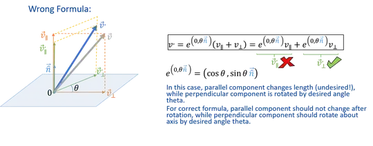

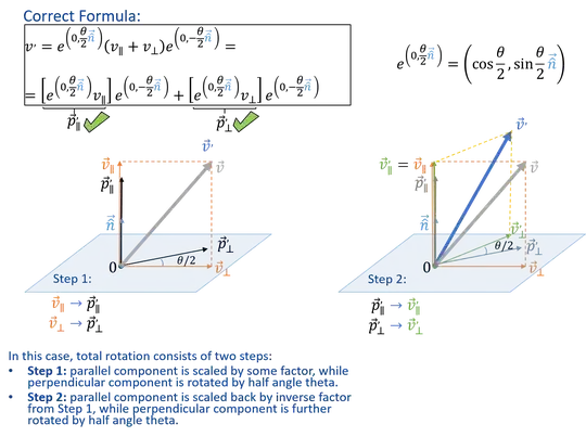

Here is a graphical representation of what happens in the incorrect and the correct cases:
Why it is not correct to use full angle for quaternion rotation
Why it is correct to use pre/post multiplication for quaternion rotation by half/minus half angle
