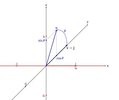

Hint:
Consider the unitary quaternion $$ u=\cos \theta + \bf{i}\sin \theta $$ and the pure imaginary quaternion ${\bf j}$. Then the product: $ u{\bf j}u^* $ (where $u^*=\cos \theta - {\bf i}\sin \theta$ is the conjugate of $u$) is: $$ (\cos \theta + {\bf i}\sin \theta){\bf j}(\cos \theta - {\bf i}\sin \theta)= (\cos \theta + {\bf i}\sin \theta)({\bf j}\cos \theta + {\bf k}\sin \theta)= $$ $$ =(\cos^2 \theta -\sin^2 \theta){\bf j}+2{\bf k}\cos \theta \sin \theta = {\bf j}\cos 2 \theta+{\bf k} \sin 2 \theta $$ that is the vector ${\bf j}$ rotated by an angle $2 \theta$ around the ${\bf i}$ axis.
Now, do the same for the other axis ${\bf j}$ and ${\bf k}$ and extend this result to any rotation around an axis ${\bf u}= u_1{\bf i}+u_2{\bf j}+u_3{\bf k}$.
